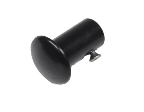

But in the meantime, the throttle is held together either by a bar end mirror or by an end-stop and spacer ( parts 17 and 18) . The end-stop is held in place by a screw which goes through the handlebar ( not shown in the picture).
http://www.themzshop.co.uk/category/420/
END PLUG.JPG (6.65 KiB) Viewed 3103 times

It seems so strange that a bar end mirror or an end cap holds the throttle tube in place as this seems to stop the throttle snapping back to a closed position when you let go!! I was just wondering what the grub screw with locking nut do that is mounted on the bracket of the throttle twist grip?

That sounds very like the friction adjustment. Inside the housing is a curved spring type thingy ( It's late and Ive just finished a nice bottle of wine!) The grub screw can be adjusted to change the drag on the throttle, so when you let go of the throttle it doesn't have to snap shut. There should be a Top hat type spacer fitted when a bar end mirror is fitted to allow the throttle to close without excessive drag ( part 19 on the diagram i posted earlier)
