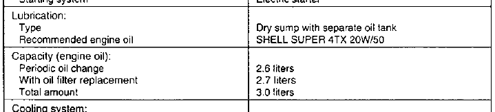

The SZR manual states:
Oil recommendation SZR.PNG (9.37 KiB) Viewed 2888 times
Some time ago I read a most interesting post by AE Haas at Ferrarichat.com about motor oil basics: http://ferrarichat.com/forum/faq.php?faq=haas_articles
"Most believe that pressure = lubrication. This is false. Flow = lubrication."

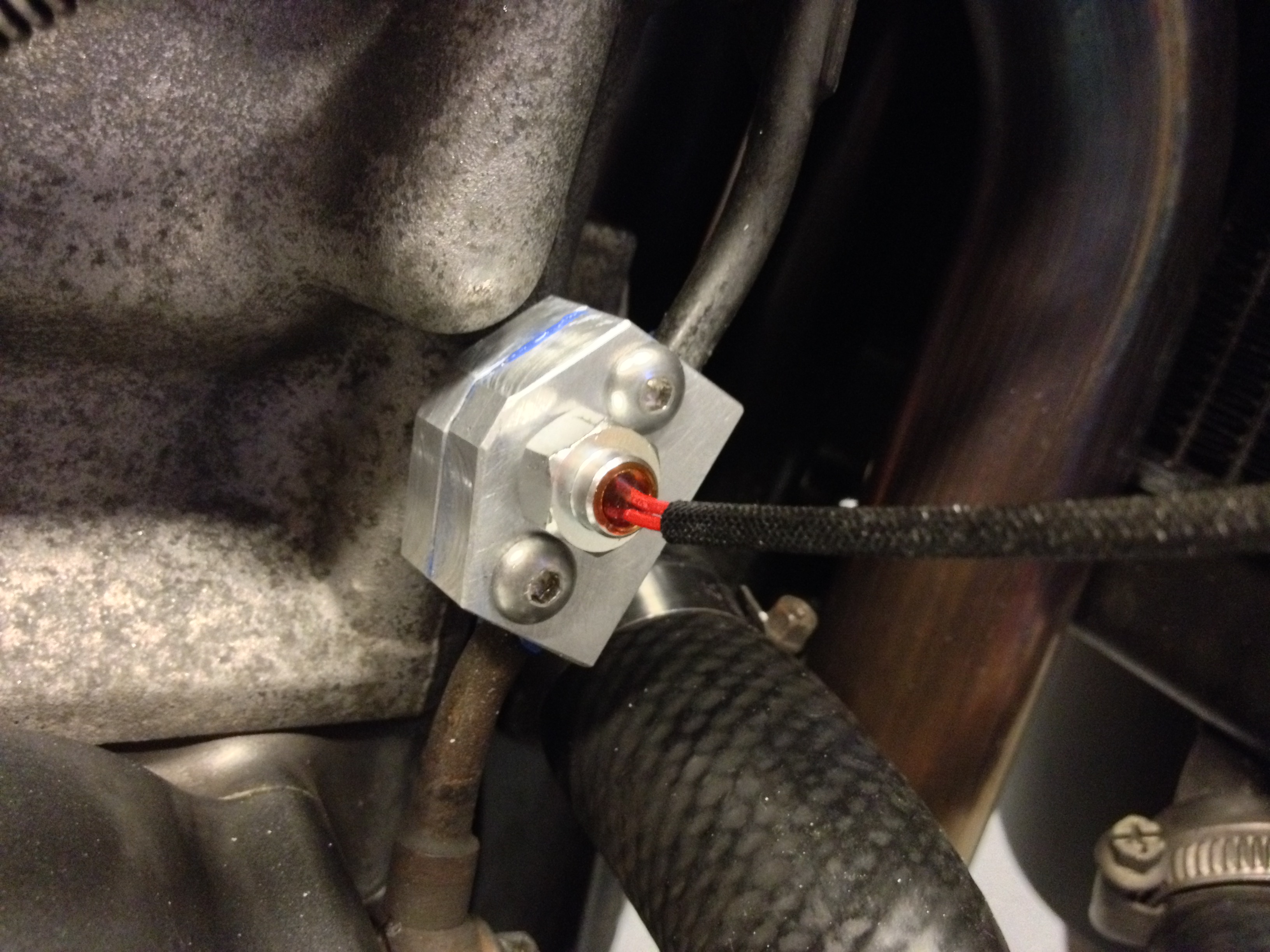

Very informative. I decided to run full synthetic Castrol 5W40 oil. Not because the engine needs thick oil when hot, but because it can get tricky when colder... after installing a temp gauge at the oil pipe from the filter housing to the camshaft the oil temp reading never got over 100 F (40 C) with ambient temperature around 45 F (7.5 C). Just to be sure I double checked the accuracy of the gauge ;-)
