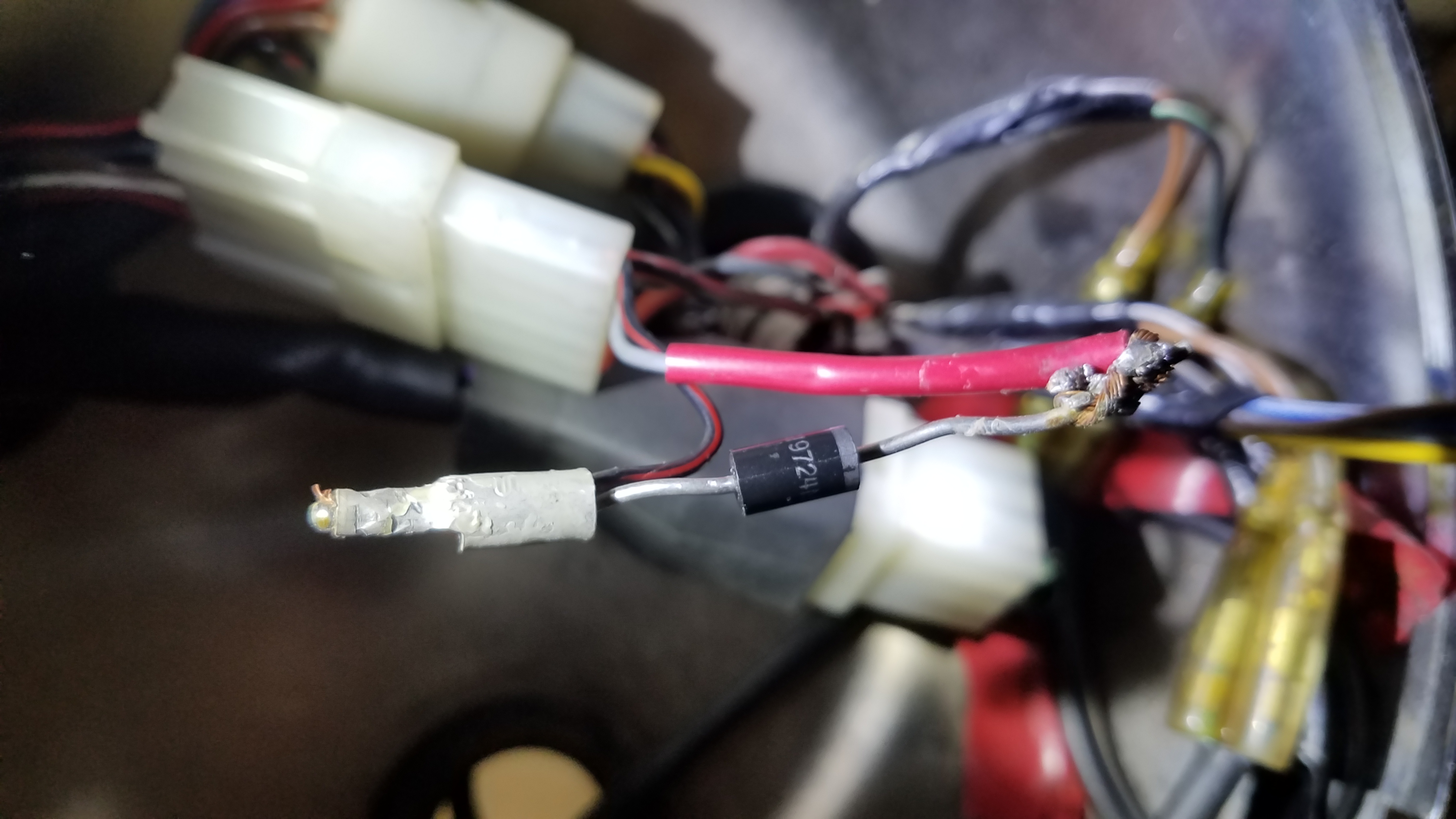

Postby Bluejay » Sat Sep 22, 2018 8:00 pm
Update:
Pulled the headlight housing again, and low & behold, there was a present waiting for me there, all wrapped up in tape. When I was in there before, I was looking for connector issues. Turns out, a previous owner had replaced the diode, and apparently didn't have proper soldering skills.
