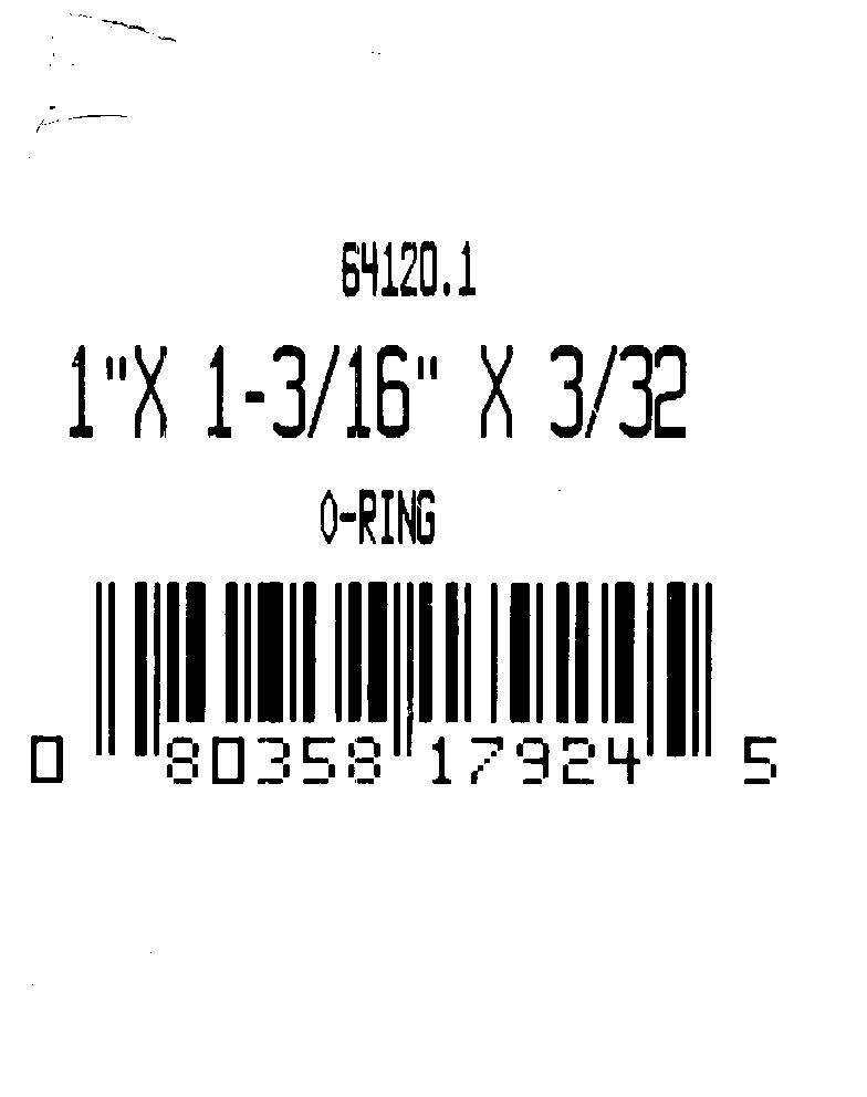

Postby DAVID THOMPSON » Sun Feb 21, 2010 12:53 pm
picture is package from my o-ring seal i used at the very top of the fork
on the top nuts
came from advanced auto parts in usa
and gives size so you can find it in other areas
if you live in a dead zone for parts i can send you some
but local source is probably best
o-ring for top nut on older mz forks
