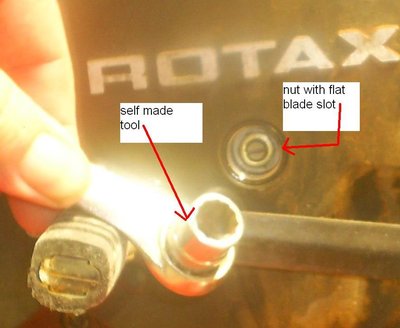

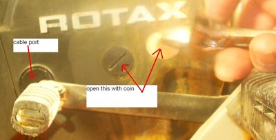

picture 1 remove plastic plug with coin or flat washer
picture 2 my hand made tool an old wrench with a socket pressed into it

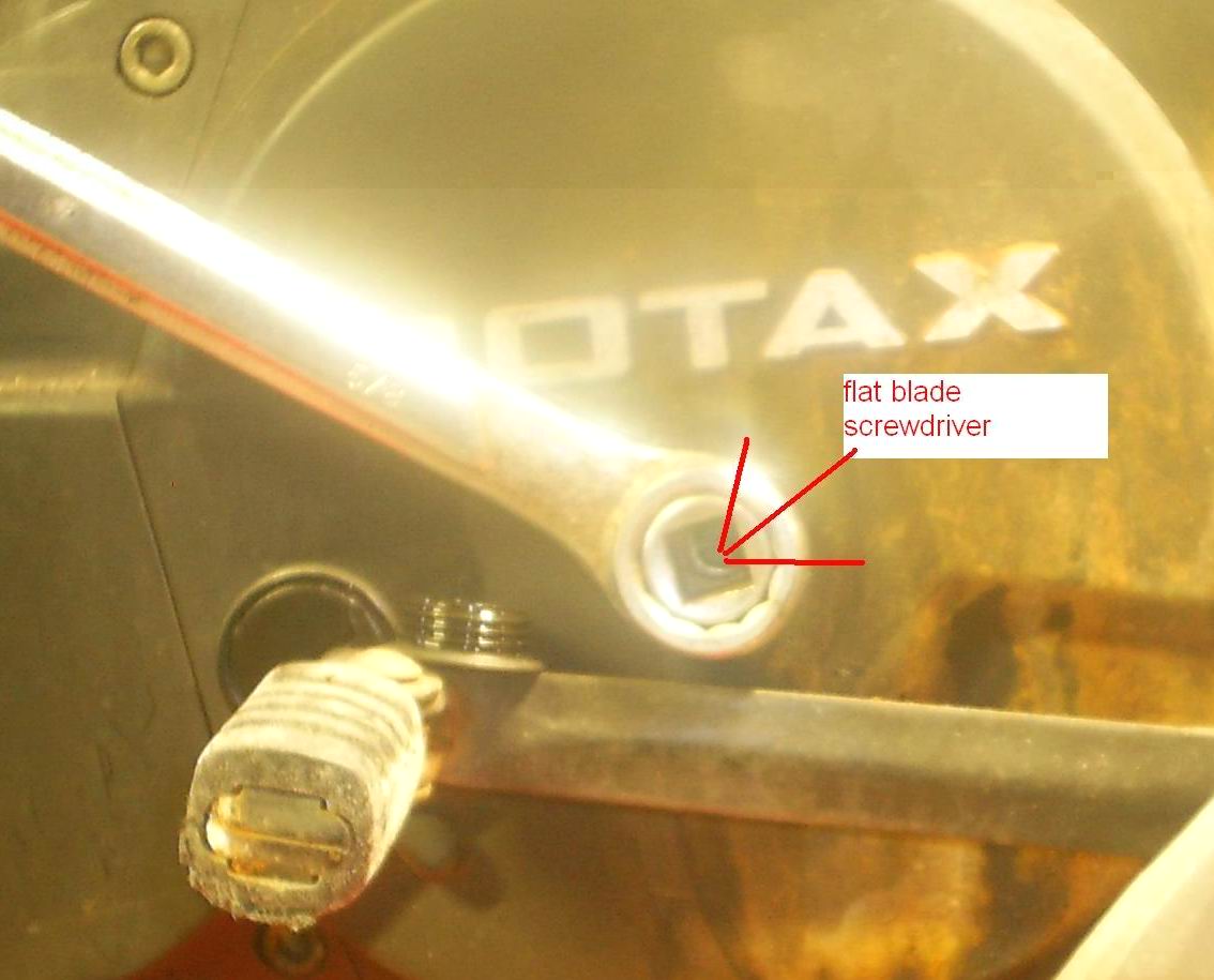

picture 3 use flat blade screw driver and wrench to adjust clutch cable
wrench was made by forcing a socket of correct size into an old spanner wrench
with an arbor press
other plug hole is used to hook up cable end when you change cable
cable hooks in a slot lay down on floor and look up in hole with a flash light
adjust the slack adjuster up top so you have some adjustment room plus or minus
then do the bottom
warning do not cross thread the plastic plugs when replacing
and do put a couple on your order from rotax as spares and carry them on a road trip
