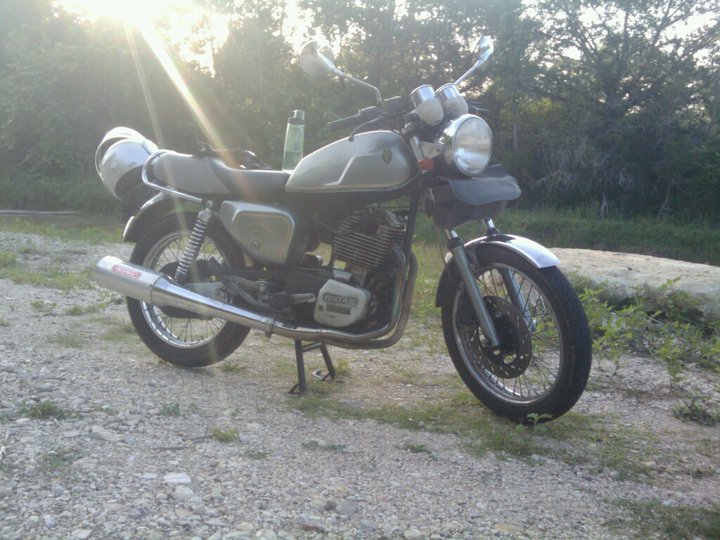

Nozz, is the Silvy in the pic with the Ron Wood megaphone the one you're riding now, or the other bike you're getting back on the road?
-Don
1-3/4 1995 Silver Stars
comanche91
Posts: 432
Location: Sweet Home Alabama
Re: valve clearances.... a how to
Postby Nozz » Sun Jun 13, 2010 2:55 pm
Don,
That's my current ride, about to turn over 50,000km. The one in bits and pieces is the one on my profile with the black and chrome tank. Of course, it will sport the Woods Rotax can as well as the 40 mm dellorto I'll send you the cam info when I see it again. I have one stock pipe and two Woods...
