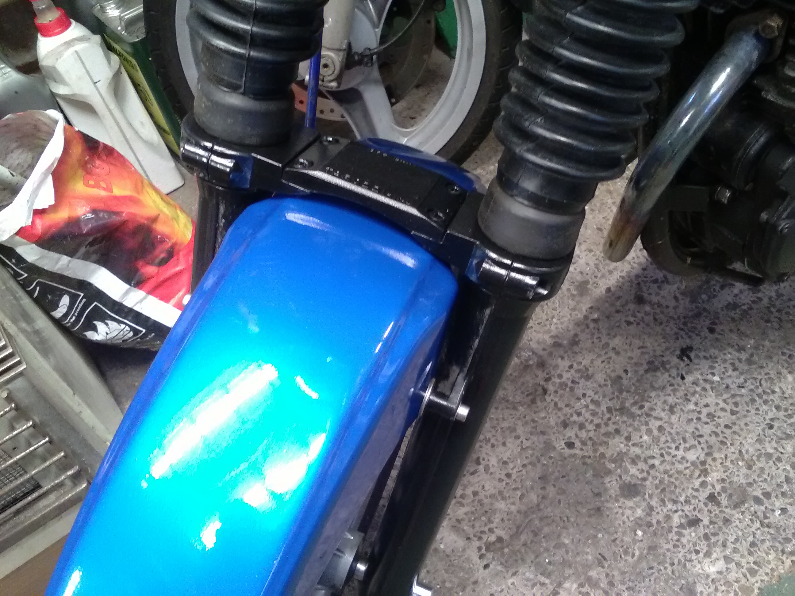

Postby ralf » Thu Nov 19, 2020 3:14 am
For anybody with an interest, I went ahead and fitted Tarozzi fork brace to my 500R and feel it has stiffened up the front end particularly under braking. Recommended.

Re: Fork brace?
Postby Puffs » Thu Nov 19, 2020 7:11 am
Ta Ralf, can you share a pic?
Posts: 2007
Re: Fork brace?
Postby ralf » Wed Dec 09, 2020 10:11 am
Sorry for the late response, photo of the brace here.
ralf
Posts: 62
Re: Fork brace?
Postby Puffs » Thu Dec 10, 2020 5:10 am
That looks very decent! Thanks.
