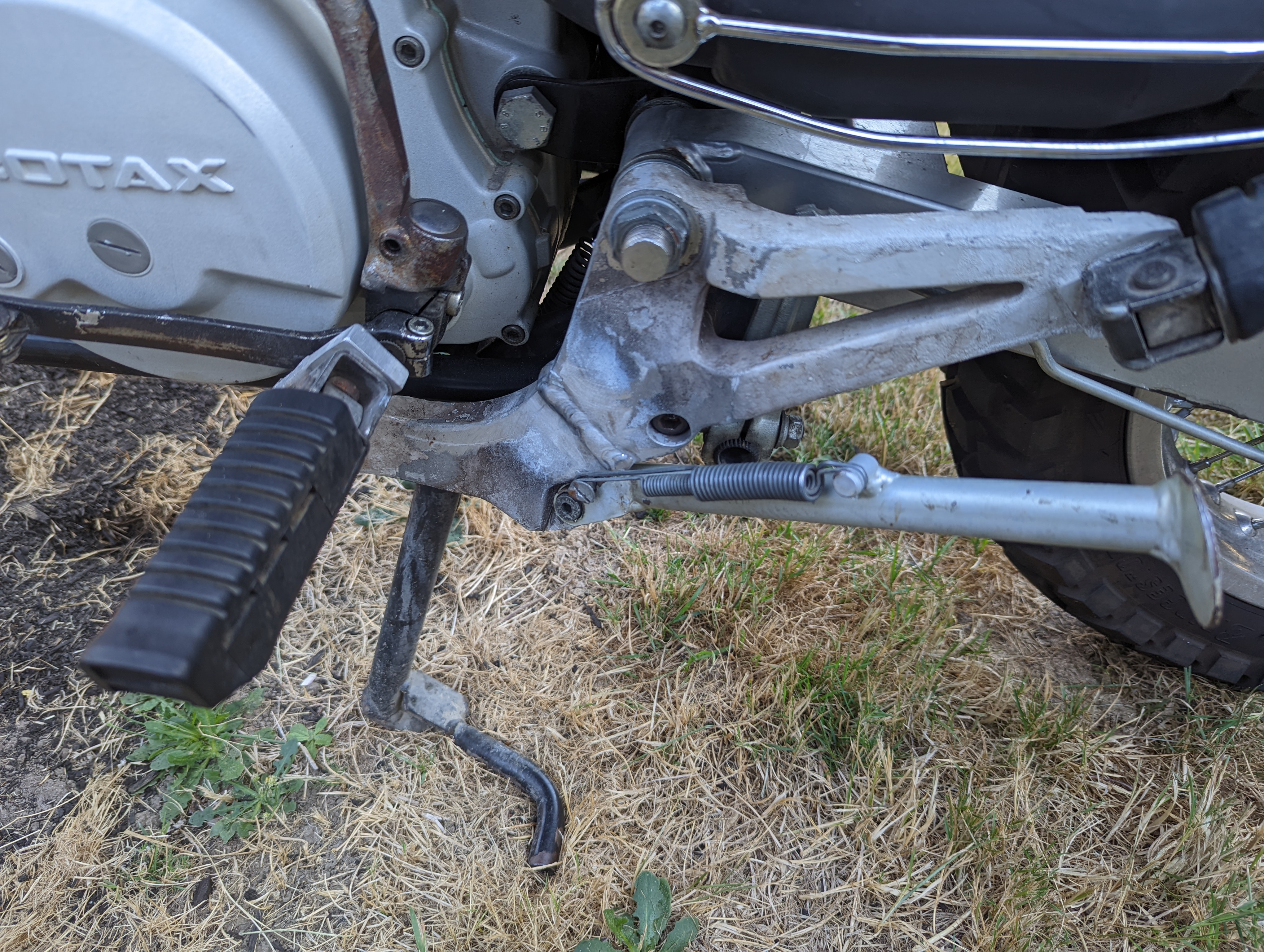

I am a new MZ owner and purchased a 500 country about two months ago. Well im also stupid and put my kickstand down in a gravel parking lot. The aluminum bracket snapped just above the kickstand bolt. I had it welded back together but its far from perfect and i would love to get a solid part to replace it. I have looked at gabors.com and they only have the Right foot rest carrier i am in need of the left one. Any insight would be much appreciated. Thanks all
My welded left bracket

i sent link that may help
the other option is to fab some steel into a home made replacement one
i am not happy with these in aluminum they break too easy
and kicking this bike to start it is a joke and on the side stand will
get you a broken keg use the center stand
Bump start down a very steep hill in 2nd gear is best if its set for a while

I think that weld looks pretty decent to be honest and i'd trust it... If you wanted the original look I suppose you could file it down a bit.
But if you really need a replacement, I think the 251 saxon models use the same bracketry?? :?: :?:
