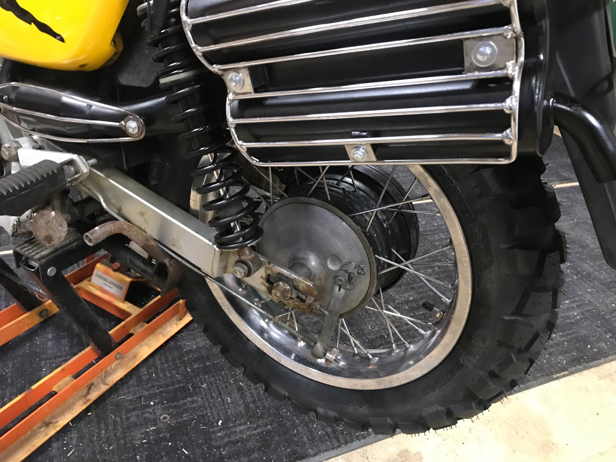

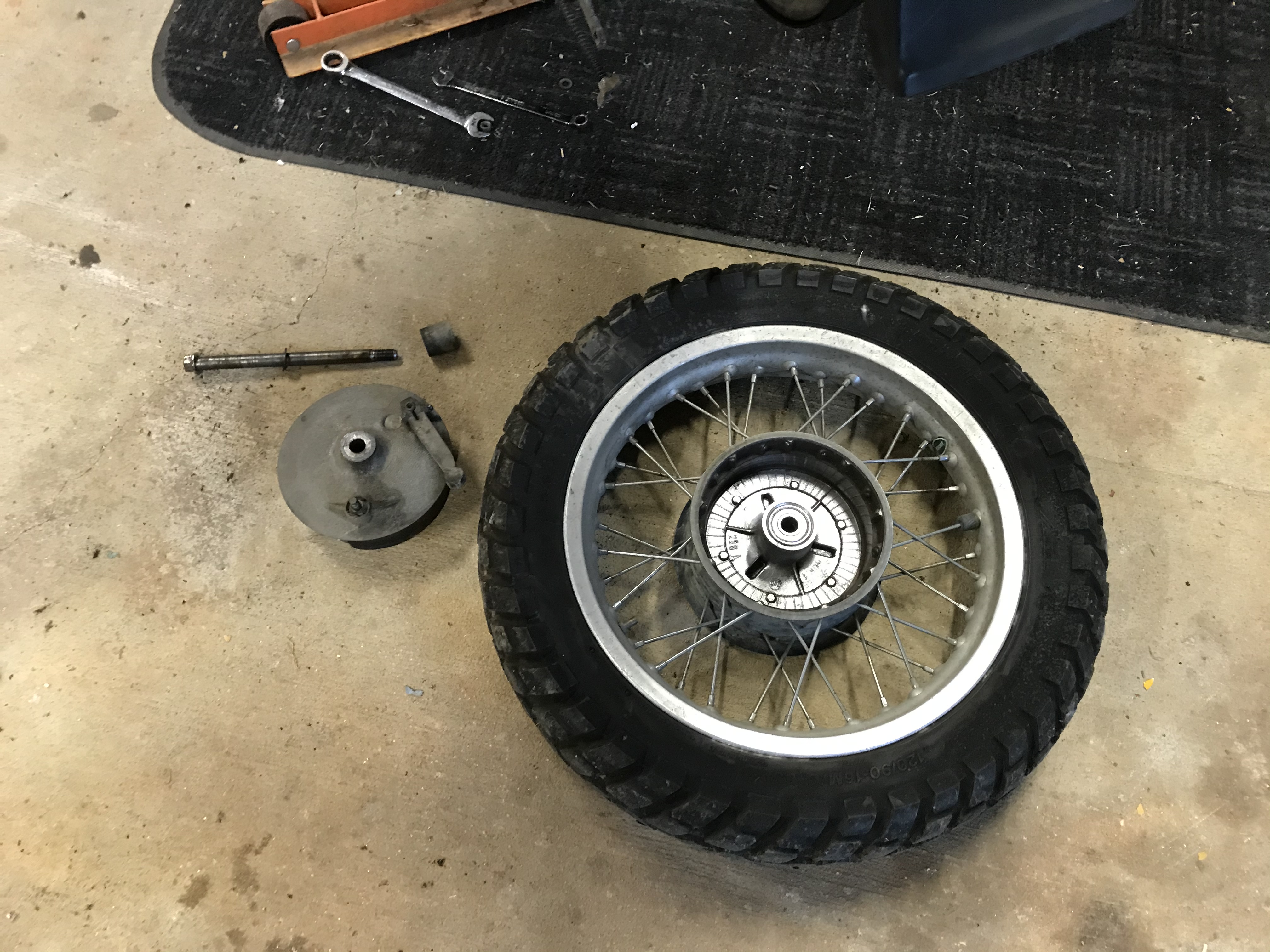

All went well removing the wheels. Easier than any bike with a chain I ever owned. The tires came off without much struggle using some small tire irons even though they were 14 year old tires. I used my hydraulic press and a piece of wood to pop the beads. I saw that on YouTube. My new tires are arriving today unless FedEx screws it up again. My welded oil pan repair was a thumbs up to Wood Brothers Racing for the repair job. Here are a few pics.

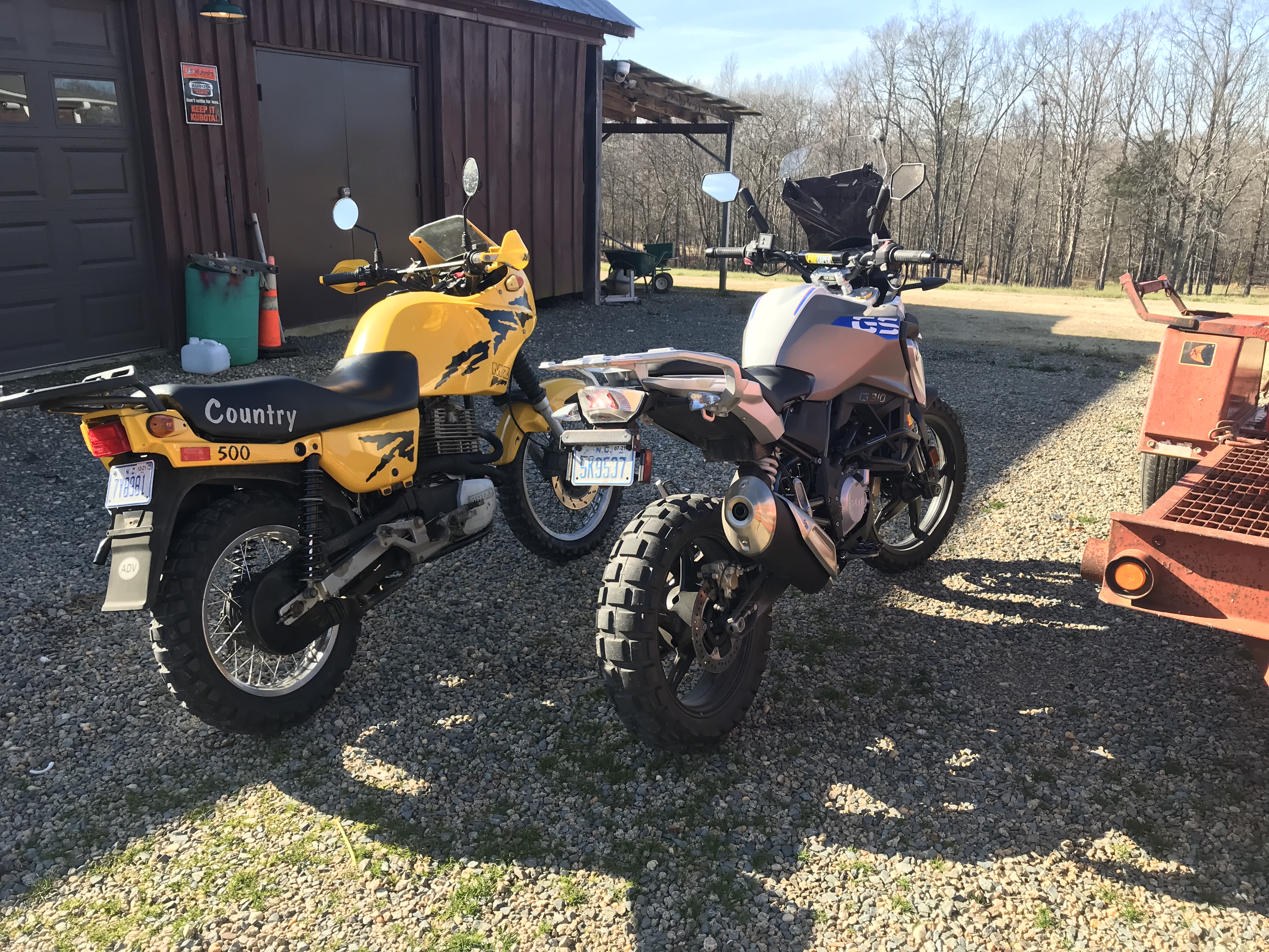

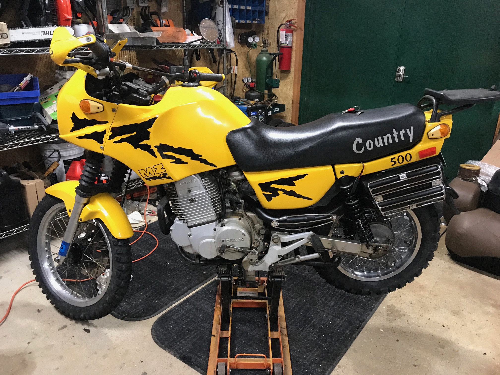

I got the new tires put on today and my air filter mod . I think Im ready to put some kilometers on her when the weather breaks.

There is very little clearance between the exhaust pipe and the chain enclosers , I was hoping they would not rub.

I went for a pretty long cool ride today on my MZ. New tires with balance beads rode pretty smooth for the rough country roads we have here. After 20 min or so I had to lower the idle at a stop sign. Hopefully I won’t have to raise it next time. Acceleration is very linear and I’m not sure about the speedo , 60 mph seemed like 80. Hard to see small Mph numbers Since the Speedo reads in kilometers. My iPhone has a speedometer app. I may check it next time. I understand why the brochure says it’s a Country and meant to be ridden in the country not the autobahn. Lol. As soon as I got back I pulled out my BMW 310 gs and ride the same route. Big difference. But I guess it should be. If I had to sell one it would be the MZ. Or list both and keep the bike that doesn’t sell first.
