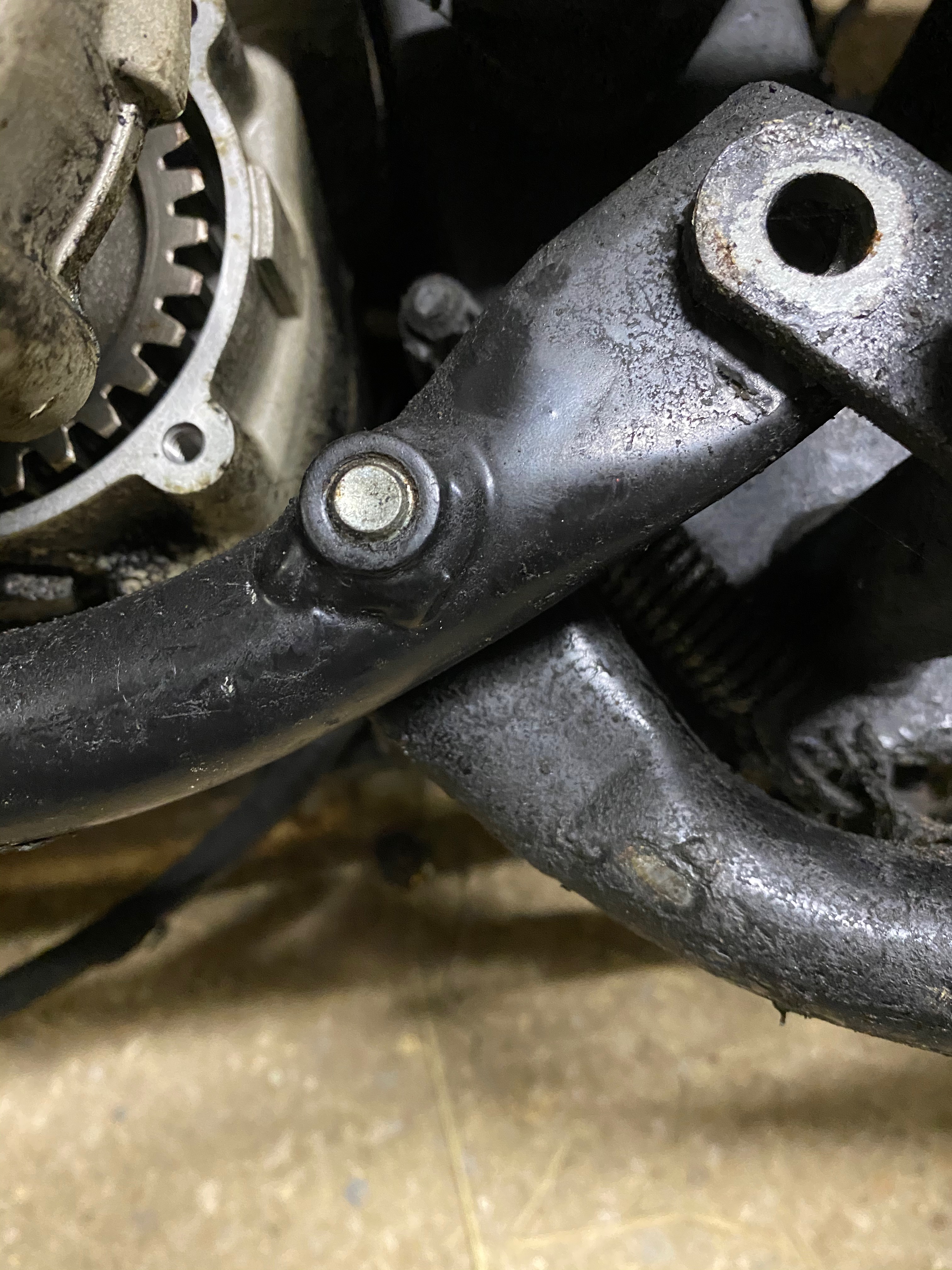

Postby horosho » Wed May 06, 2020 5:32 pm
It looks like there are lugs in the frame that it mounts into. This is a 96 Silver Star Gespann.
1995 Silver Star Classic Gespann
horosho
Posts: 20
Joined: Tue Jan 06, 2004 2:45 pm
Location: Cincinnati

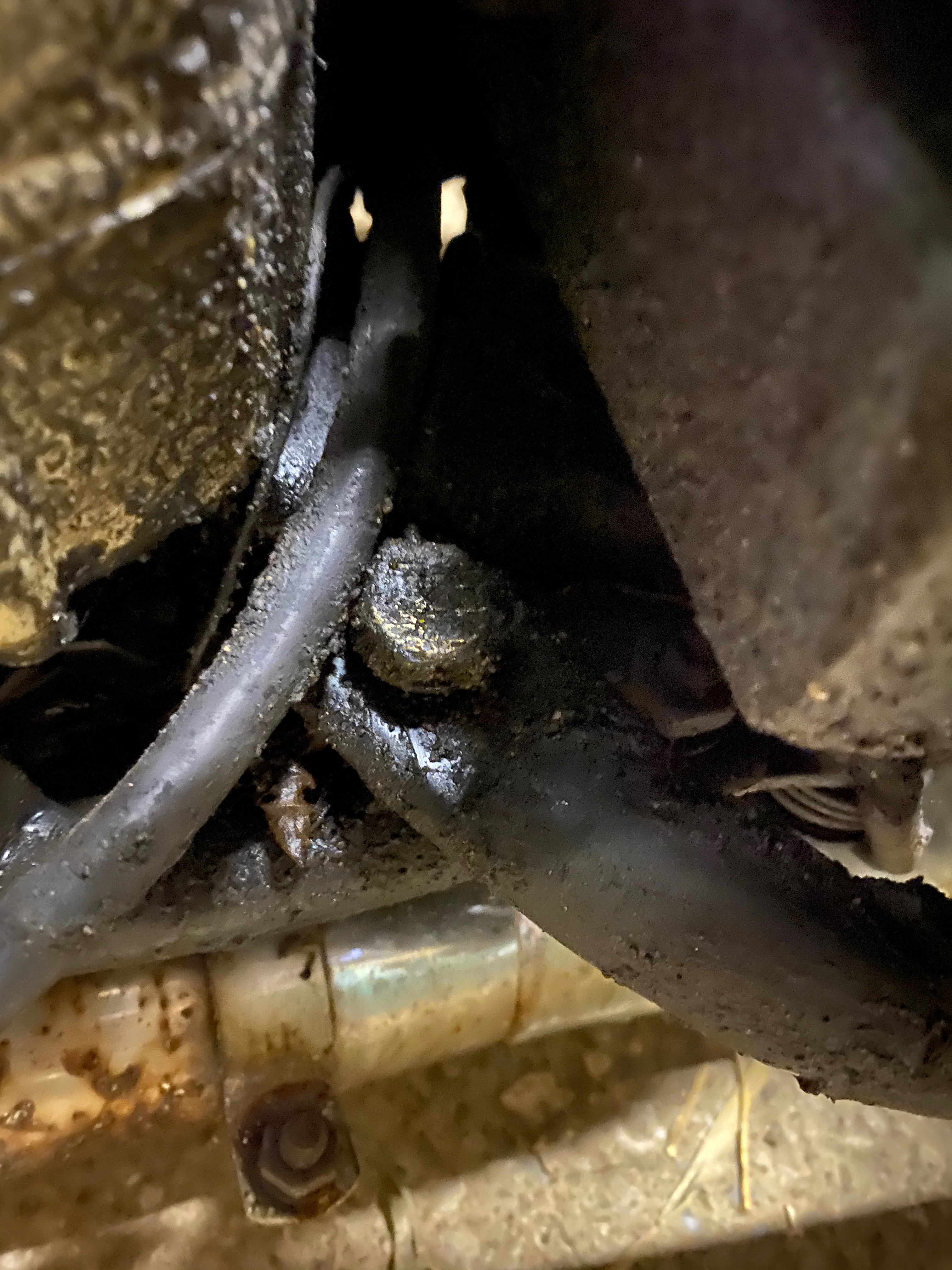

Postby horosho » Wed May 06, 2020 5:36 pm
This is the other side, let me know if you want more pictures.
Where did you find the centerstand online?
