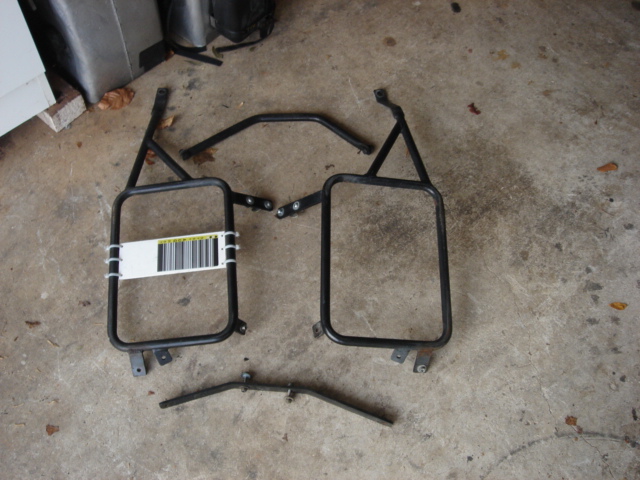

I have the touratech racks, mounting kit, and liner bags. I made my own "cinder blocks" and saved a bunch of money. I dont know if any other bags fit. The tube that runs from one rack to the other in the licence plate area does NOT attach to the :hoop: or the fender. Hack away on the hoop. Be aware, if you are running a m4 can it is right in the way of the tube, not a big deal if you have a welder, just add some new tabs to attach to.
I am happy with the touratech racks, they fit nice and are real strong.
Please post some pictures of your fender set up.
[/img]

The pic is extremely helpful. I'm thinking that I'll easily be able to attach my Tourmaster Cortechs to that rack (provided I can get a luggage repair shop to fix them). If you happen to know off the top of your head, could you tell me what the dimensions of the rectangular bag stays (or mounts or whatever you call them) are? You don't have to bother measuring them. I just figured you might remember, if you've adapted other bags to fit them.
