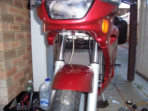

Postby sapperk9 » Mon Dec 04, 2006 2:48 pm
My left hand fan died at age 5 yrs.
On examination I found that the header had conducted "hot" through the fan sahft to the fan. Melted fan from the middle! The motor is a model aircraft type, not the most confidence inspiring item.
Seems like a system fault, but Phil at BSA Regal has the bits for replacement. I then modded the radiator to gain an extra 5mm seperation from the header by a slight tilt forward from the top.
All seems OK now.
Radiator home made screen, you can just see the additional tilt on the mounting peg at top centre. On full right turn the radiator cap just touches the suspension leg.
