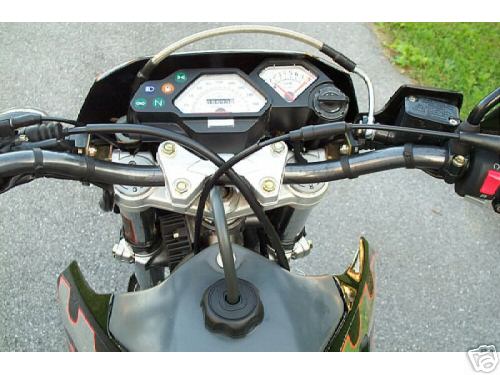

this would be a neat instrument conversion, really like the Tach!! :-D

For those who dont know this is a picture of a standard Husqvana intrument panel. I think it could be persuded to fit. I am not sure if its an electronic or mechanical revcounter, but this should be do-able. If its electronic its just a matter of picking the pulse up from the ignition circuit. A mechanical drive that fits the MZ engine is available from Yamaha, you need to get eh standard bits from teh Tenere XTZ660 or SRZ660 from teh UK.

Just found out, the revcounter shown is electronic
