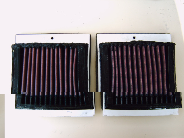

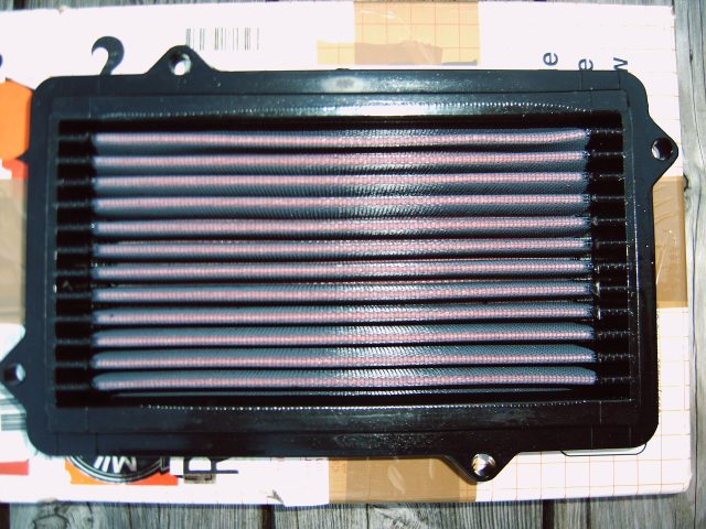

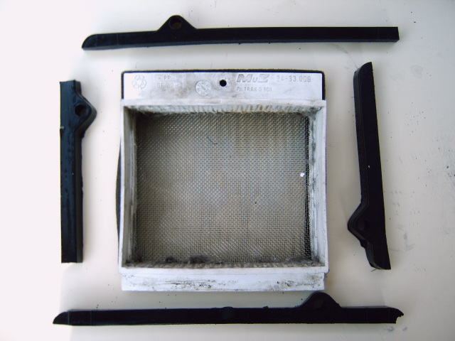

Paul van der Wouwer over at the Belgian/Dutch MonoForum posted a sort dity on how to make a new K&Nfor the Skorpion from a Standard K&N car filter.
http://forum.monoconnection.nl/viewtopic.php?t=908&highlight=luchtfilter
Like here, you need to be registered to actually do anything there. It is worth it tho, since it is certianly the best of the various fora covering our topic but also the all other Yamaha and Honda singles. If you ask in English, you get an answer in English, tho that is true of all of both German fora as well, both of which also require registration:
Skorpion Forum
SZR Forum
Several of the SZR owners, me too, also have a Skorpion and it is the same engine in a similar bike.
You need a K&N filter for a HONDA civic crx, 85'-87' nr;33-2021.
http://www.knfilters.com/search/product.aspx?Prod=33-2021
Honda filter
2301 220.jpg (160.91 KiB) Viewed 3356 times
you will get two inserts from this.
clean out original MZ frame
2301 222.jpg (95.26 KiB) Viewed 3355 times
Trim a piece of the Honda filter to fit and "glue" it into to the cleaned frame with a good petrol resistance silicon adhesive.
finished
2301 221.jpg (93.24 KiB) Viewed 3357 times
