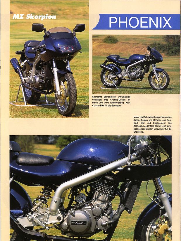

whatever the causes of your problems, the fuel pump is not the cure.
Countless Skorpions run and have been running without the pump. Really good dealers here removed the pumps right at the start before even selling the bike. The prototypes had no pump to start with.
austrian press report 1993
See if you can find one in these pics. And while you're looking, cast a glance at the Brembo wheels (3.5" rear), fully adjustable RSU fork (from TZ250R), aluminum swingarm or those pretty rearsets... You may also think you see a steeper steering head: they had 24º instead of the 26º the series then had. Better quicker handling without sticking the fork thru or jacking up the tail...
These prototypes were the ones tested by chosen dealers and racers in Spain 1993. They have the frame with the bonded CNC maschined aluminum swingarm mounts. Based on these and personal experience during the testng, many such dealers ordered as many as 100 machines.
They got what they got. In the States, that would have been cause for legal action and MZ would have disappeared right then.
