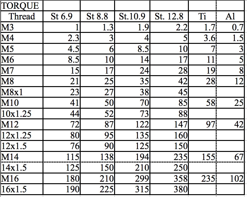

In your case, I would just use standard Allenhead machine screws of at least 10.9 rating.
There are no hi-tensile plated bolts on the market; that is not a regular product. The OEM bolts with most manufacturers are not hi-tensile at all. MZ's are soft as butter so careful when attempting to remove them or you'll end up with a very round hole instead of a hex.
Yamaha's are only slightly better in Quality but they are 5mm wrenchsized instead of the usual 6mm and have shallow hole. Both use Loctite. Best to heat the bolt with a blowtorch first, then a sharp smack on the head with an impact hammer.
Do NOT use Loctite. Use Schnorr saftey washers and the proper torque for the M8 bolts.
obviously in meter/kilogram, not in foot/pounds.
Also use a correct thread grease or the torque wrench is just stage prop.
The Loctite used in industrial assembly is pre-applied and dry. It functions both as a torqueing lubricant and after setting again as an adhesive.
