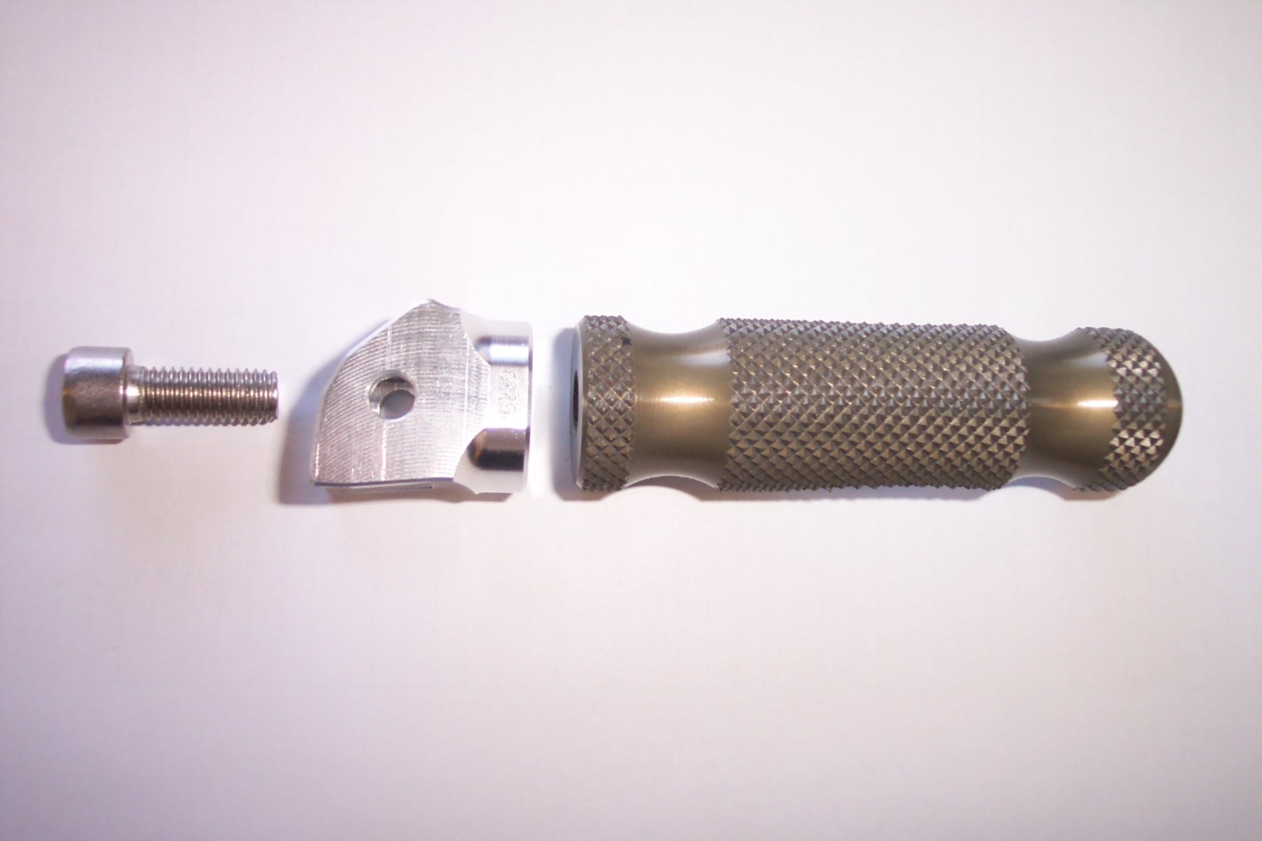

I admit that I don't have a direct lever mounted any more on my Skorpion. Most will have noted that I have the Gilles rearsets and they have NO slop at all, so the only slop you get is that of the Yamaha transmission itself and you have that with the direct lever as well. And I have Gilles' Rollnase(=free revolving toe peg) which is a dream.
It is hard-anodized and revolves freely around the centerbolt. BTW you can also see that the engine lever has two lengths, the foot lever 3, and the nose itself als has three positions. You can set from nearly no movement to quite a lot as well as to fit the toe of the boot. And of course 1st up or down. Needless to say, I have 1st up. They are also pretty strong; you can see that the peg has grounded but you'll be hard put to find any other damage. Nothing broken. In the meantime I have changes back to the old style peg which I much prefer.
The newer are lighter and smaller:

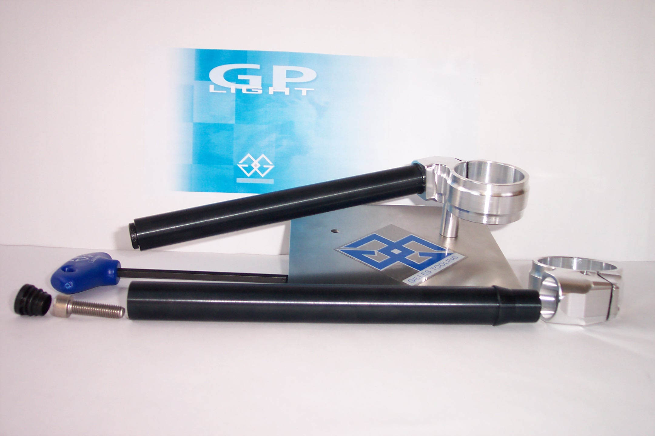

While I have the dealer CD in the drive, here are the GP Light clipons I keep recommending:
that is how they are delivered, complete with long allenhead wrench.
