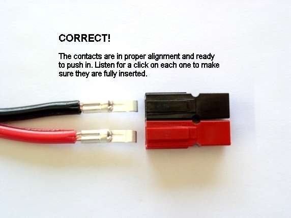

Postby DAVID THOMPSON » Mon Sep 03, 2012 8:47 am
spade lugs were loose on my coil once
just a pure accident i spotted it quickly...
i have noticed that the spades on all 3 of my mz bikes seem to not stay tight
in fact i have gone to soldering them on where there connected on the rt125
i remove the spade and just solder them to the connection point
in some places i have used Anderson power pole connectors
direct soldering makes it hard to work on later ..but has brought the its dead and has to be hauled home drill to a stop
power pole picture
i use them to replace connector plugs that have died on bikes and cars
best to solder the wires on the lugs as the wrong crimp tool can mess them up
if soldered they can be taken apart and reused. there not cheap but nothing is cheap any more
if there is a good HAM RADIO STORE in your town they most often stock them
i get mine from this company when they show up at a ham flea market every year
they bring a huge table of all kinds of radio connectors
http://www.pl-259.com/
