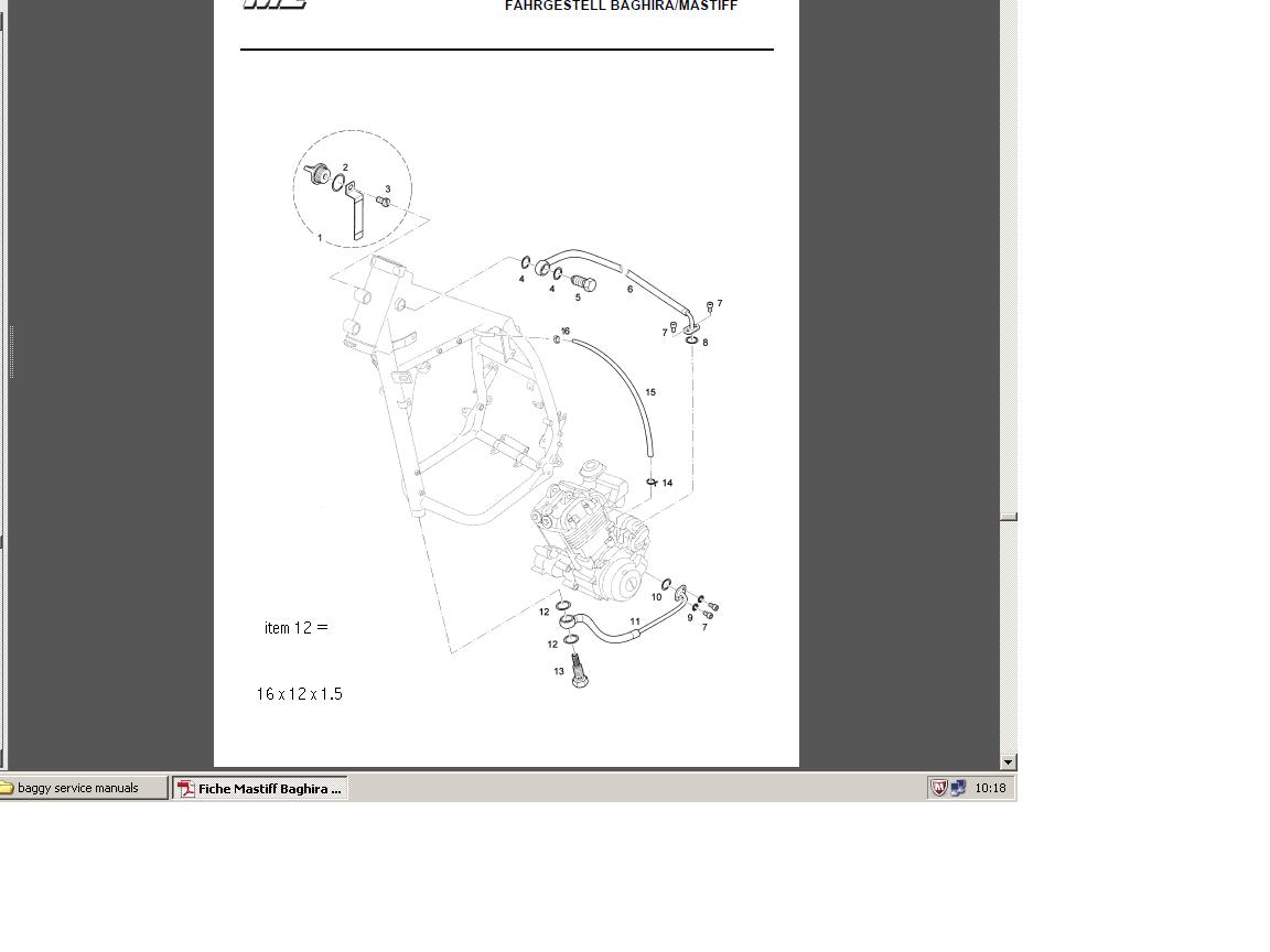

Postby den » Tue May 21, 2013 4:22 am
oil line for baggy

Postby den » Tue May 21, 2013 11:40 am
duncmac wrote:Cheers Den
Cant find any 16 x 12 washers so have emailed grahams spares to see if they can advise or provide.
most oil line banjos are of a standard ,just go to any car motor factors and ask for copper washers, cheap as chips, i think i remember seeing some in halfords,,sump plug washer 16 x 12
