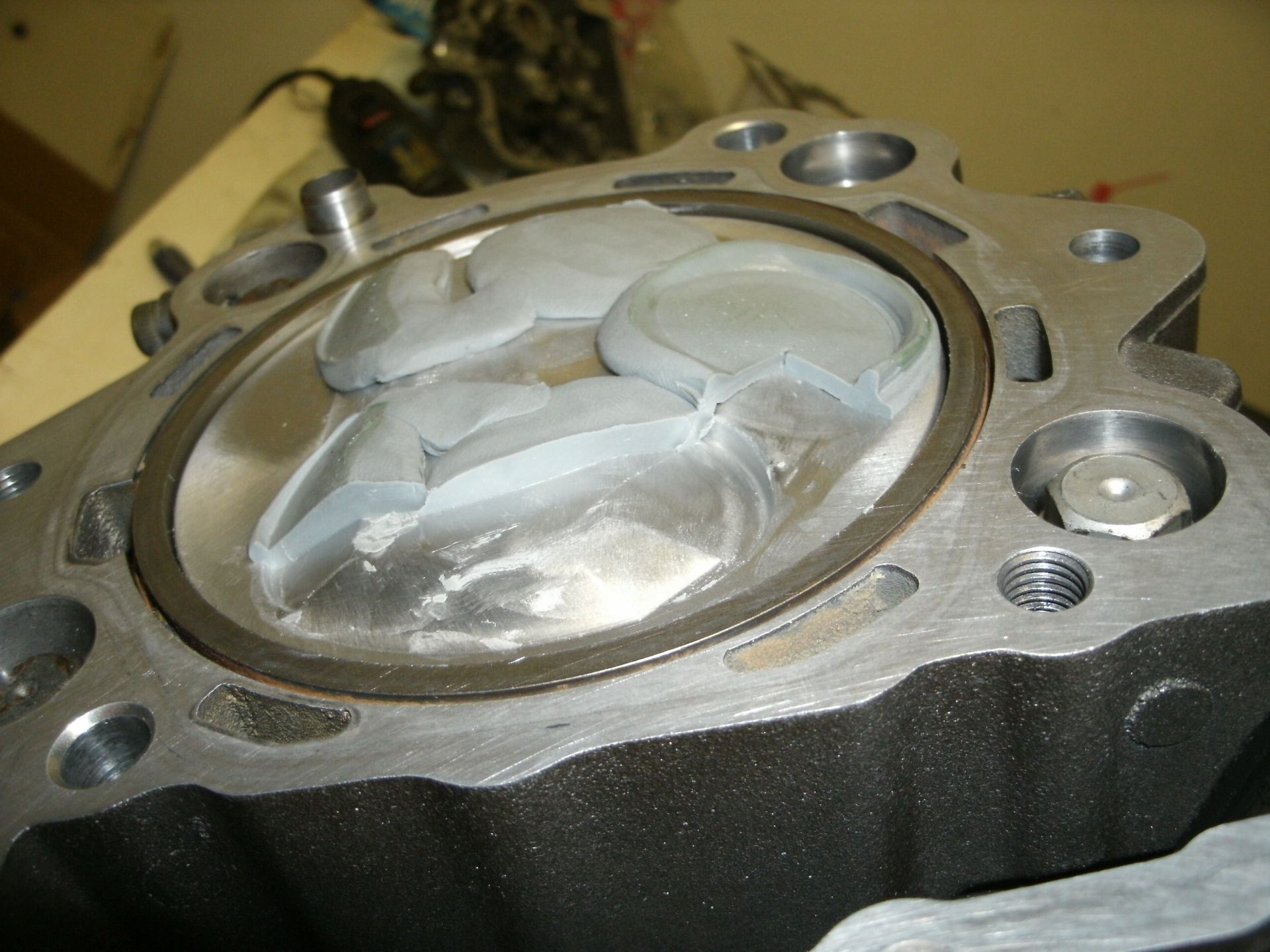

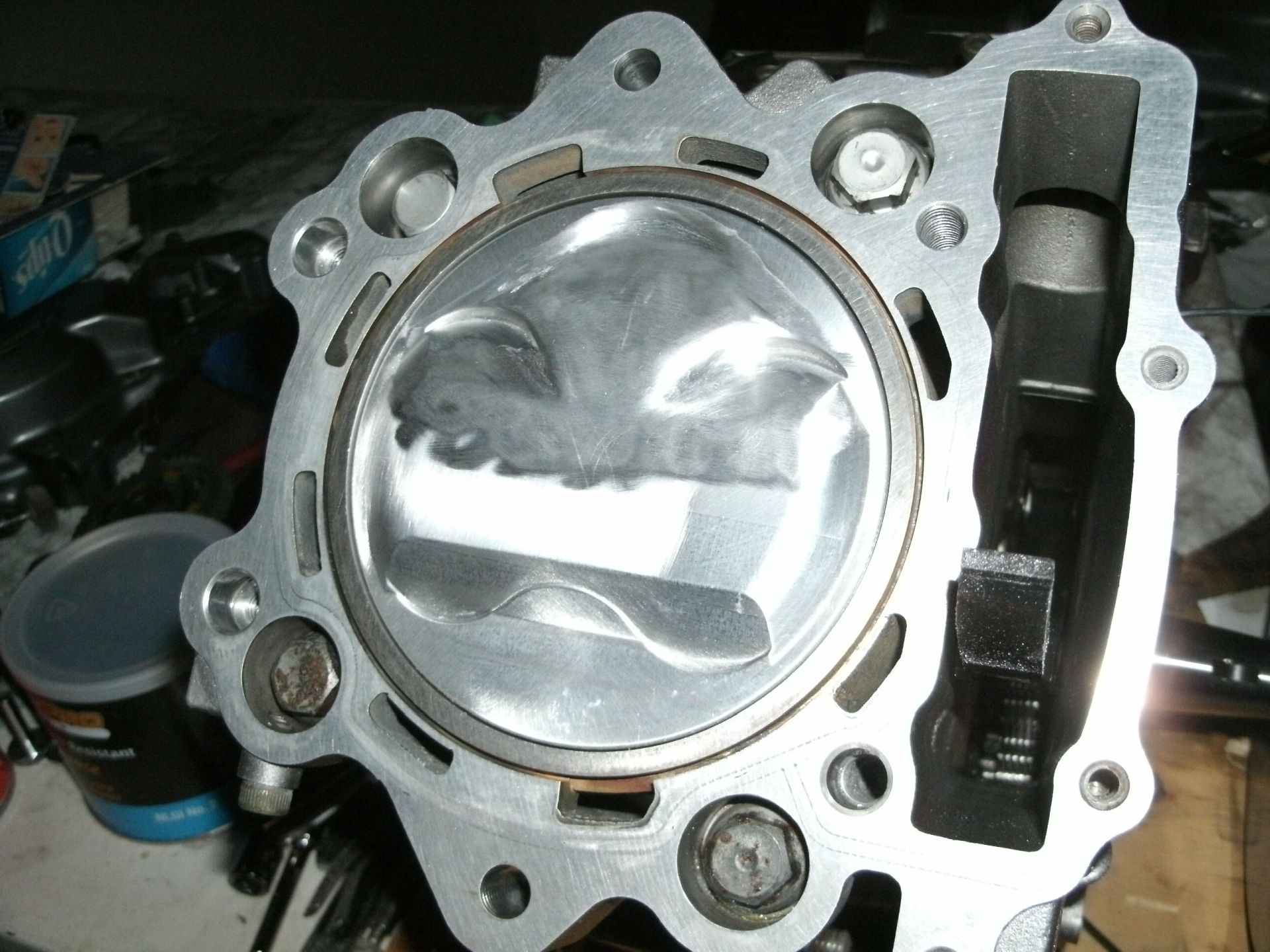

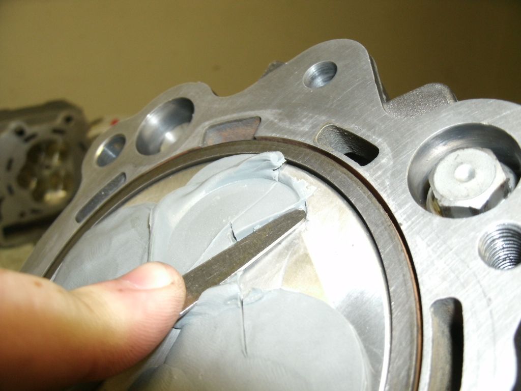

Looks like I'm cutting it mighty close on my piston/valve clearance. By my best guess, I have about .050" with the old head gasket, which is .009" thinner than the new Cometic gasket. Is the .055 - .060" range going to be enough room? :?: :?: :?: Edit: I also had no valve lash for this test so I may be able to add another .005 - .007" to those clearances.
That gauge is a .035.

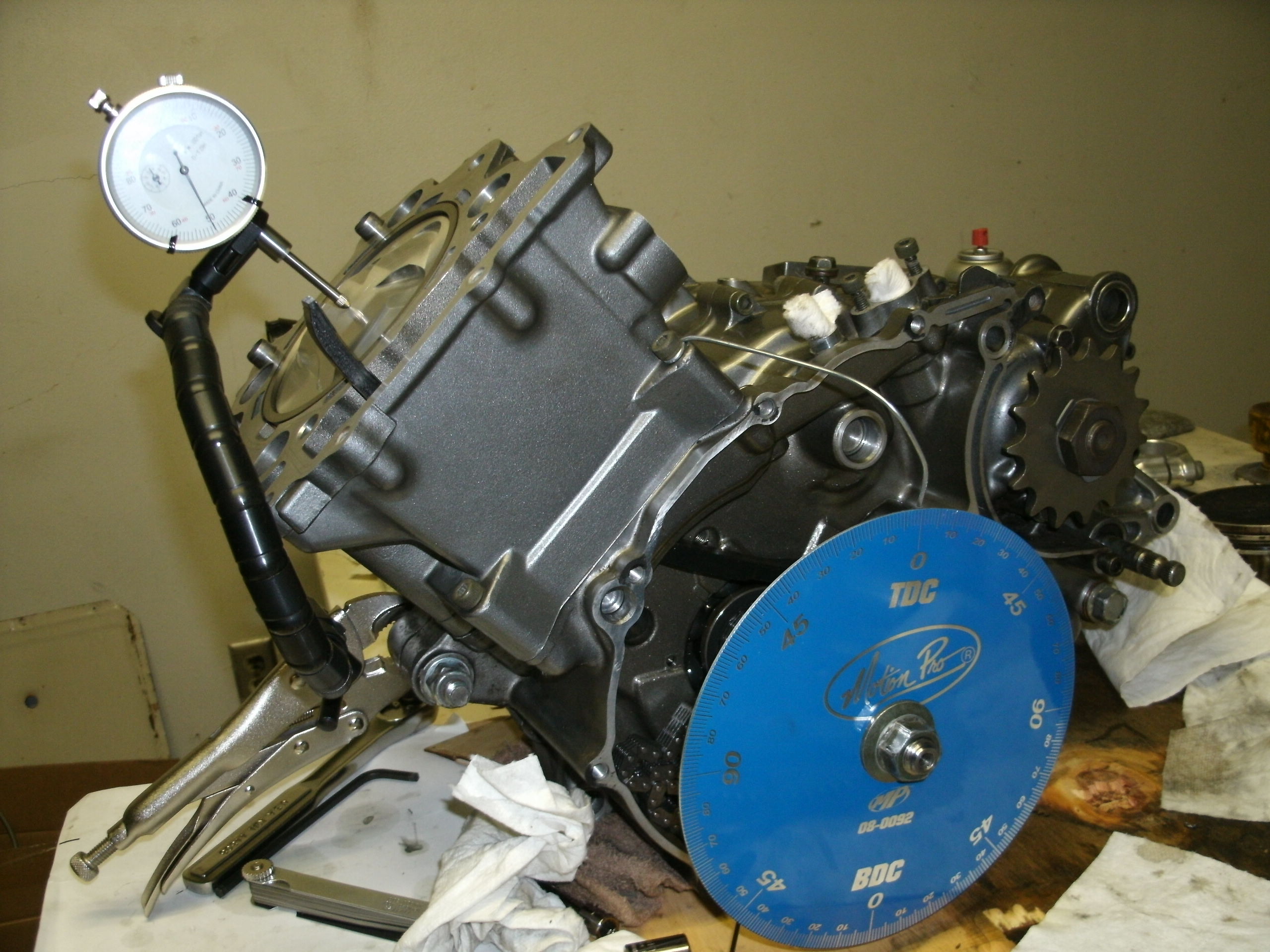

Postby edfmaniac » Wed Jun 05, 2013 12:25 am
If you need a cam degreeing kit, don't fork out the dough for the Hotcams kit. Just buy the Motion Pro degree wheel($13), go pick up a flex mount, clamp base dial indicator from Harbor Freight($35) and use the method in the picture for finding TDC instead a piston stop. After fighting the wheel to get it synched up with the crank, I just took a degree reading at a known distance below either side of TDC(2 degrees and 27 degrees) and split the difference to get my actual TDC(14.5 degrees).

After speaking with the machinist, he said that I wasn't getting quite enough clearance and the best thing to do would be to open up the pocket on the piston. Problem solved.

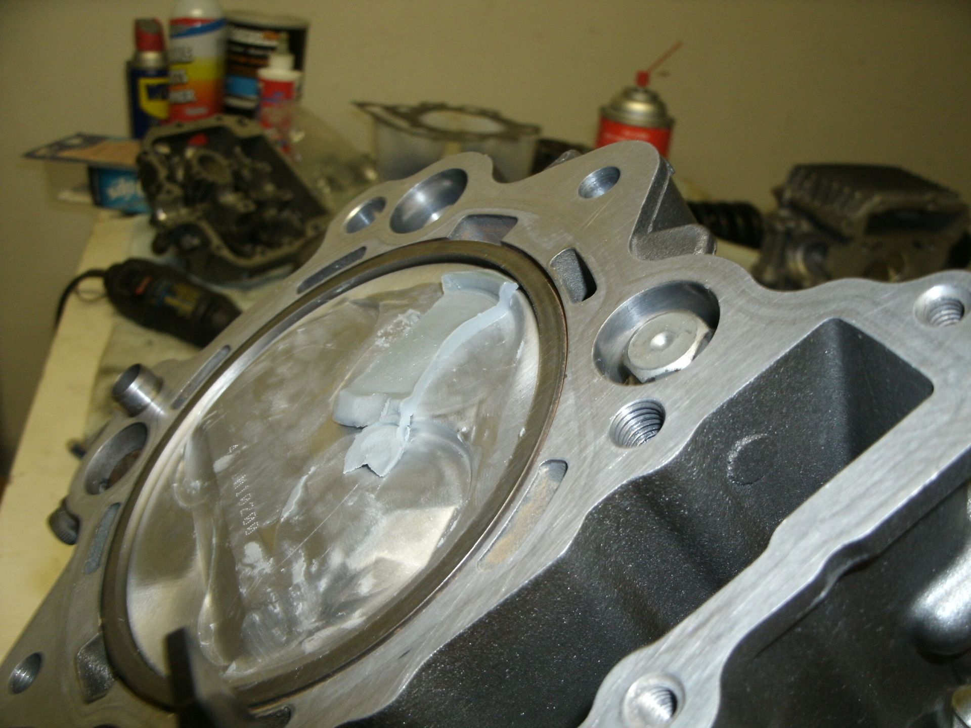

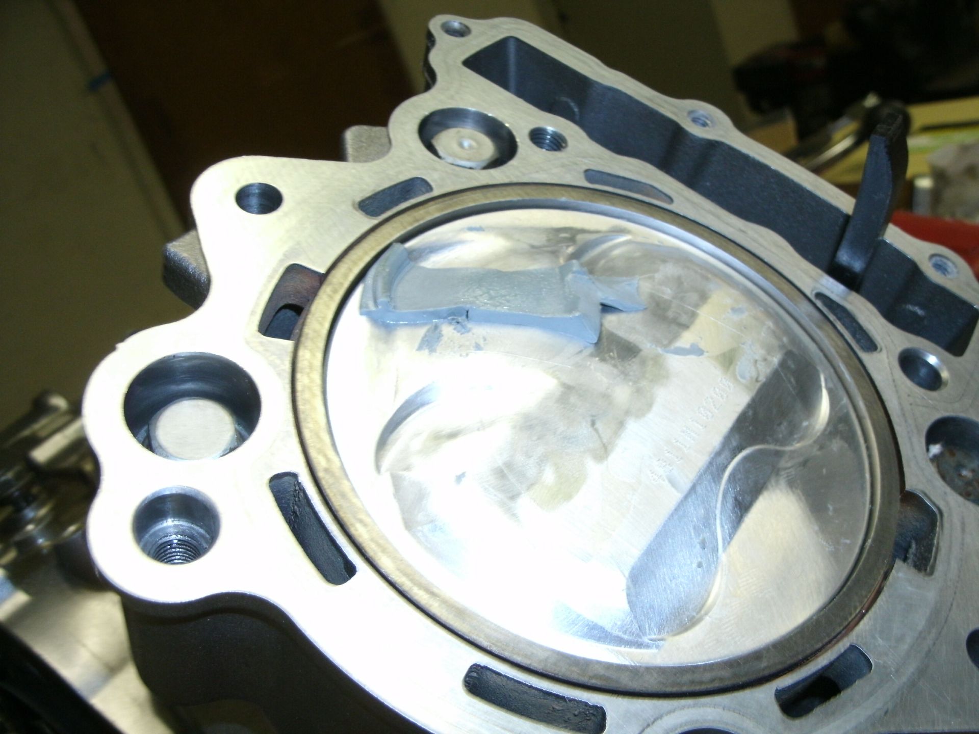

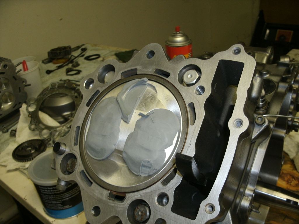

Postby edfmaniac » Thu Jun 06, 2013 8:09 pm
After the second round of clay, things are looking a lot better, and I don't think I will need to modify my cam sprocket. The timing was only 2 degrees retarded and the nice lady at Megacycle said that was acceptable. Evidently a few degrees in the other direction can reduce the valve/piston clearance. My new results show nothing closer than .090" so I should be ready for final assembly.
Postby Bill Jurgenson » Thu Jun 06, 2013 10:52 pm
from experience, I can say that you must have at least 1mm tolerance piston edge/top of cylinder, otherwise the piston will hit the head. This is due both to tipping of the piston and elongation of the conrod. OTOH i have never had problems with valve clearance. BUT never run a Megacycle without recommended valvesprings, either from Kibblewhite or RD. For the 5-valve head the Kibblewhite set is the best bet, both from my experience as well as various professionally recommendations given to me personally. I am running RDs in my 4-valve engine but these are not the catalogue set. They were the result of a telephone conversation with RD.
Do not fool around with the head gasket. If you need more height, use a thicker base gasket. Make it yourself as necessary from soft aluminum and use a suitable silicon sealant.
Postby edfmaniac » Thu Jun 06, 2013 11:41 pm
I'm right on the limit then. It's hard to get the piston exactly level but I'm at about .96mm. Kibblewhite springs installed.
