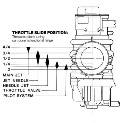

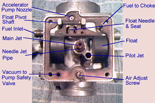

hi maty , I would suggest you have a look on youtube ,,there are plenty of baggy and Yamaha 660 videos there , you will be able to see and hear what's going on to others so as to compare your own , my fourth gear will take me up to the rev limiter easily enough and fifth gear is like a motorway gear, just for plodding along. But don't worry , you in good hands here , If there's anything these people don't know it probably isn't worth knowing. I suspect a little carb cleaning and check the air screw position , here you'll see what part of the carb is in use in relation to the throttle position, and the other photo is where these parts are located ,
