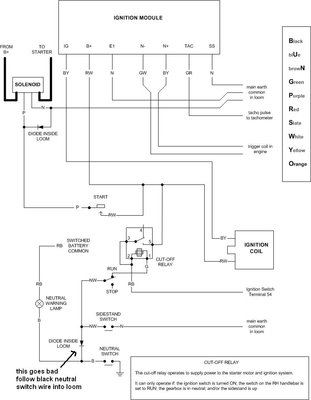

I am new to this forum and from south Africa. I have an 660 MZ engine (think its an 660) and the whole wiring loom plus carbs. I am looking for an wiring diagram for the engine but cant find one in SA.
I am busy with an duel purpose bike build. I am building the engine into a Yamaha WR 426 rolling chassis. I want to make up my own loom with only nessasery wires and switches. the engine number 4NN-001451
please is there any one out there to help me??

some one posted a link to this
and the place that drew it sells lots of neat things you can use
tony idle did the drawing with some notes added by wd8cyv dave
and a drawing as a pdf from
http://www.silent-hektik.com/
the pdf is there drawing and is posted here to help you and them fix your bike
as always right click on pic a couple times to make it bigger
then left click and choose save as to save to computer for printing for your shop notes
tony idle did the drawing i added some notes dave
mz mini wire harness.pdf
(363.33 KiB) Downloaded 164 times

Postby Bill Jurgenson » Sun Aug 04, 2013 11:23 pm
if it really is the Skorpion harness, throw it away as far as possible.
I posted the SilentHektik links and have been using their electronic fuse box for over 10 years. My last two Skorpions had one-off harnesses I made using that fuse box.
If you really need it I can mail you pdfs of the original Skorpion harness.
