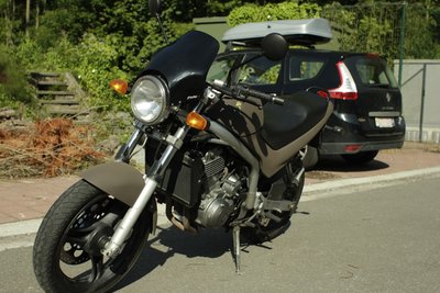

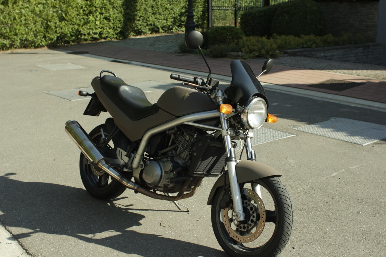

Postby Zoonan » Sat Aug 17, 2013 1:07 pm
So this is the result. Before it was blue.

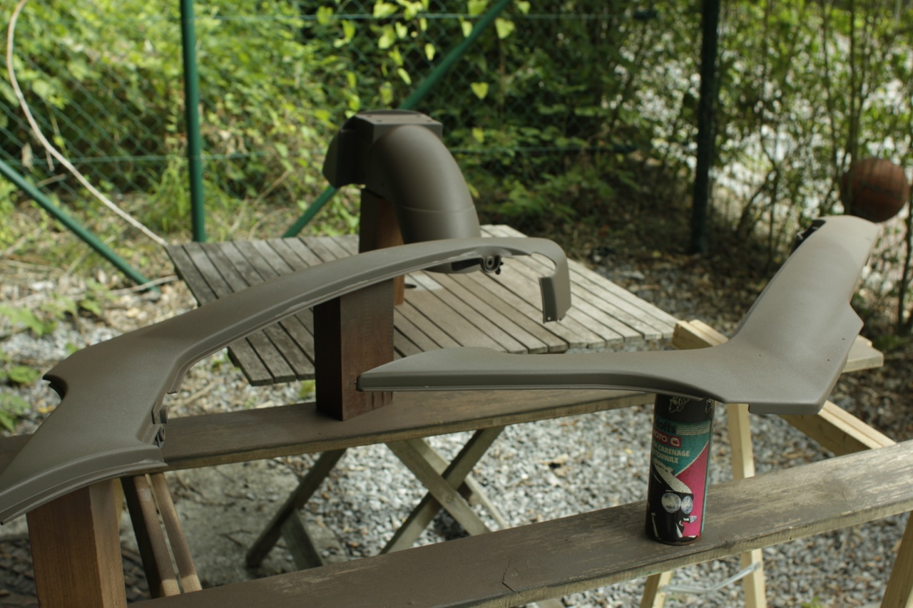

Postby Zoonan » Sun Aug 18, 2013 1:20 pm
I took off the fuel tank, the front thing above the wheel and the side panels. Then i sprayed 5 layers of Plasti Dip with 12 minute intervals.
All this with two cans of the product, but I admit 3 cans would be better. But I can still do it if necessary.
Anyway the result is great I think.

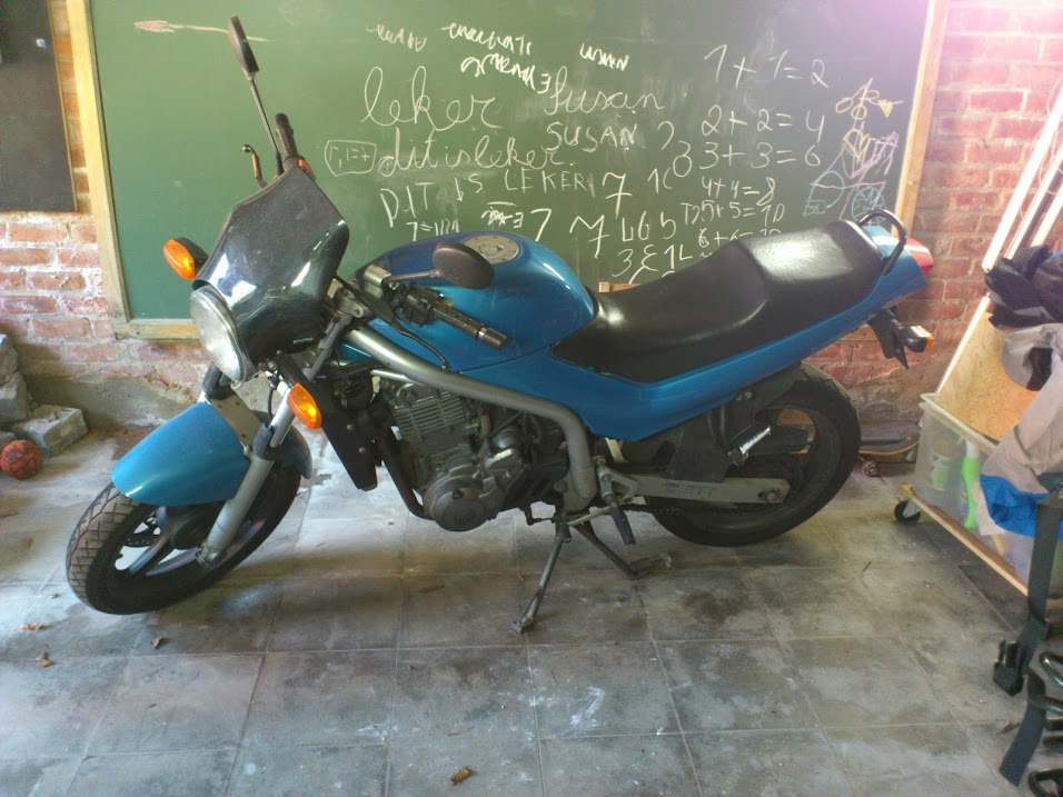

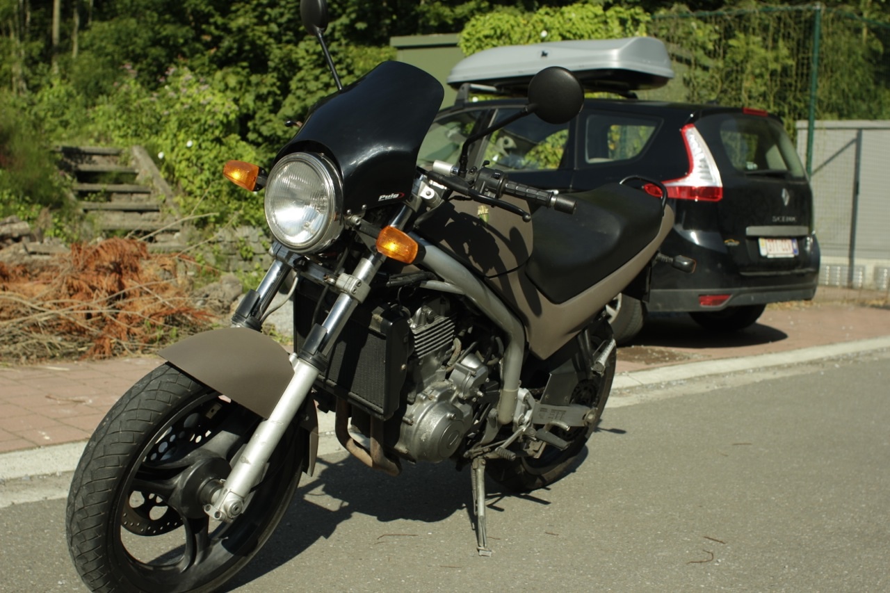

Some pics of the color change:
after
some parts
Before Plasti Dip
