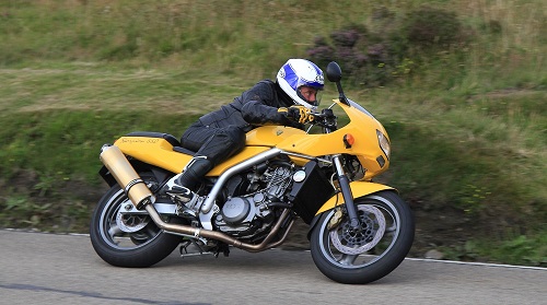

Got around the link pipe prob by having a local exhaust shop knock one up out of stainless. 50mm outlet then gives you a world of choice for slip on cans. This one cost £25 used but needed a db killer to make it less offensive.
