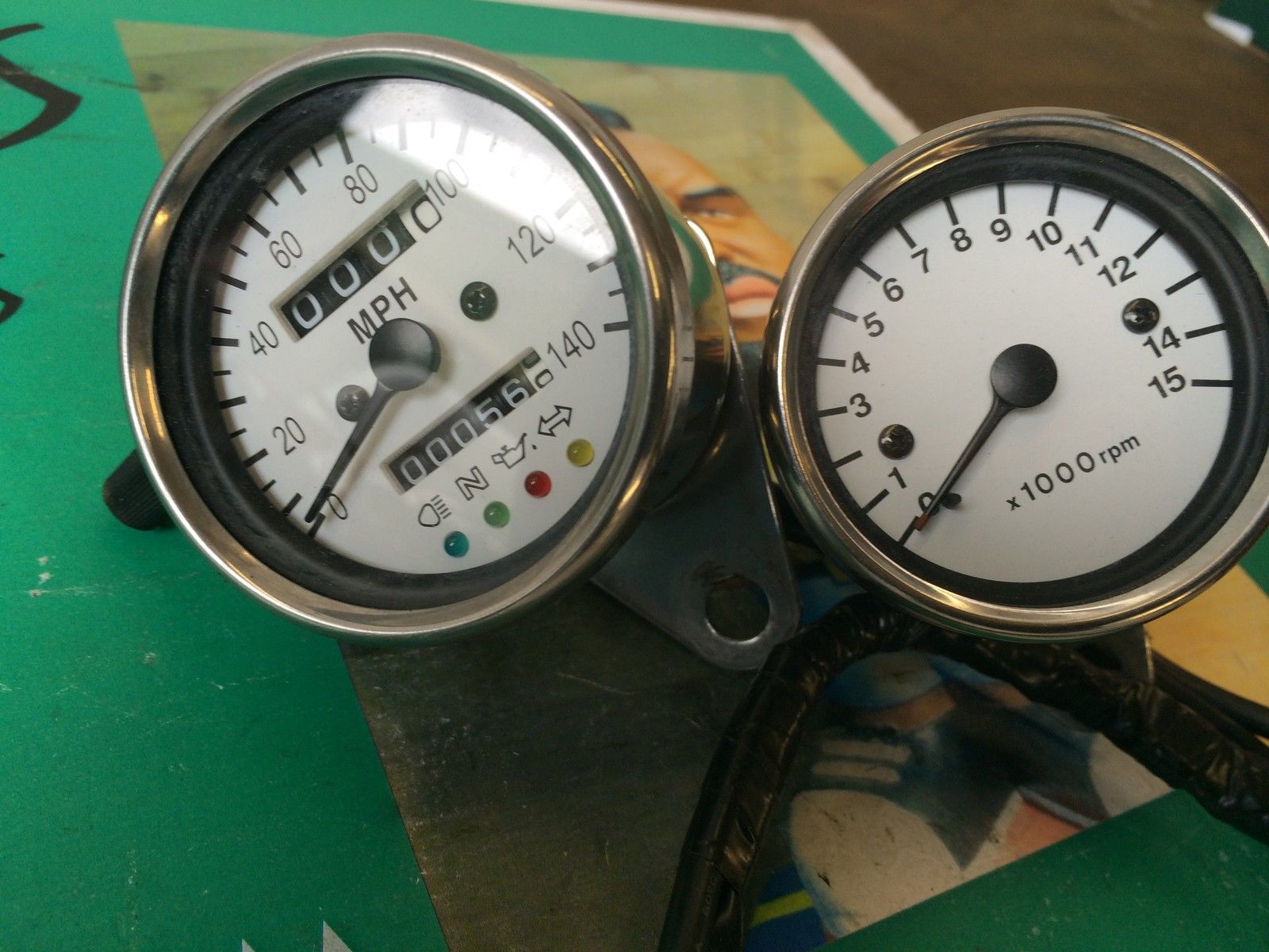

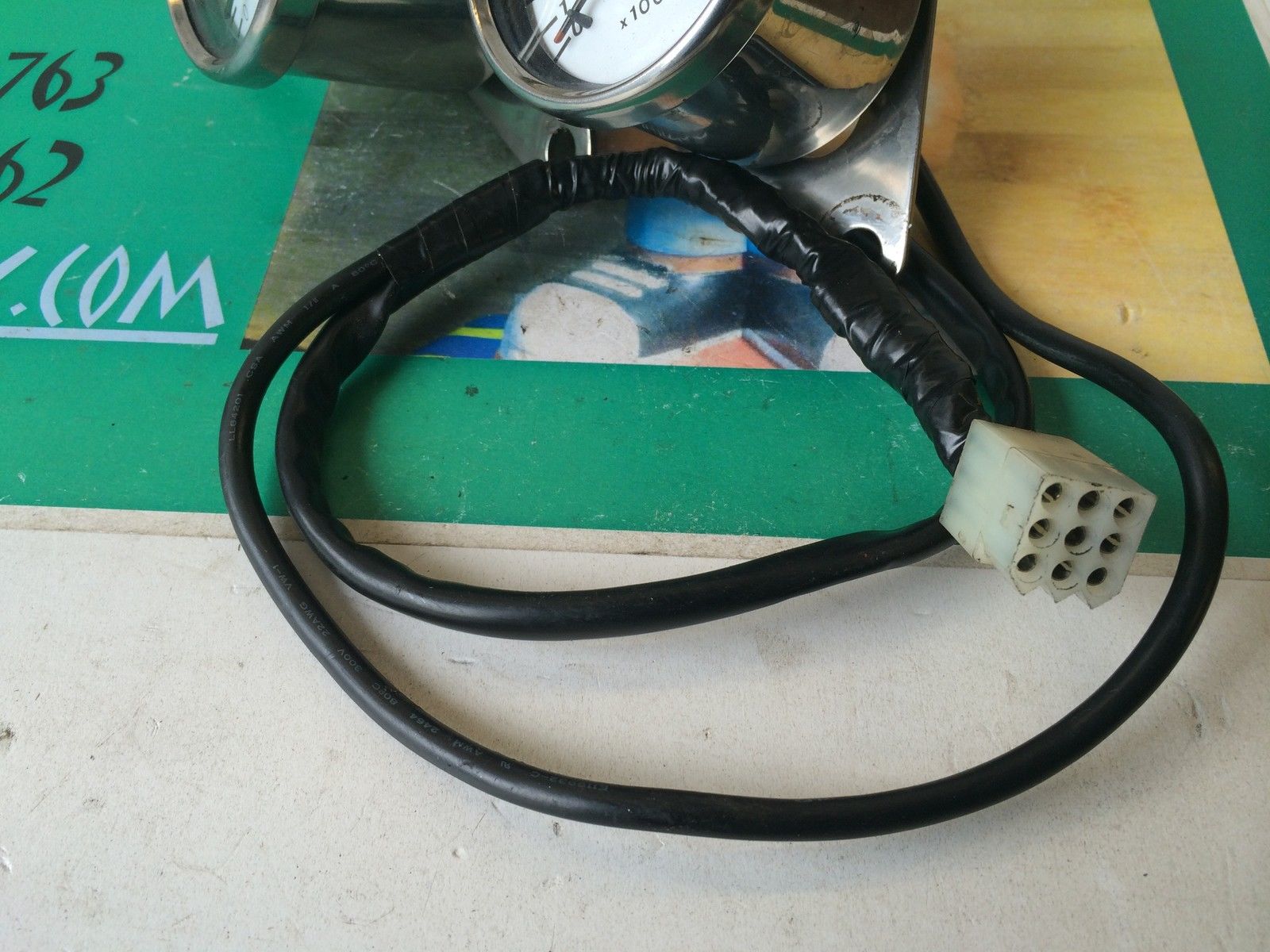

Postby Chalks » Mon Jun 09, 2014 1:46 am
I spotted these on Ebay:
eBay item number:151320472487
