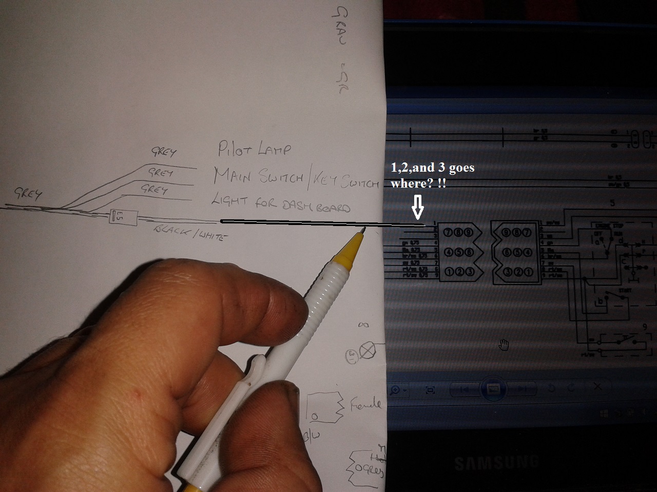

I found the fault, it seams that I switched the 2 wires that goes into the small pilot ( daylight) lamp of the headlamp. The positive was connected to the negative and when I switched on the light the grey wires (positive ) grounded (shorted ) themselves !!
Now I traced ite grey wires to a diode and since the wires are pretty cooked up I drew up a diagram how they should be attached.
Can anyone confirm that its correct.
What wattage should the diode be (12 volts ok need the watts)
Also (not so much important) the Black and White wire has a dead end in the wiring diagram ?? any ideas? it seems to go into the lights switch
Nice day to all :wink:

Postby edfmaniac » Thu Oct 08, 2015 4:29 pm
I don't know where those go. Sorry.

since my bike was sold in Europe the wiring philosophy is different.
power is sent to the pilot rear light and pilot front headlamp when you set the key on park. The diode 6Amp and some 400 volts(safe for motorcycle applications)
will prevent current to flow to the instruments lights. On the other hand if you switch the lights on power will flow to the pilot rear light ,pilot front headlamp and instrument lights.
So I replaced the melted wires, replaced some brown (earth wiring from 3 wires rear indicators and rear light to single 1mm one) checked the wiring loom wire by wire. freshly taped contacts cleaned.
