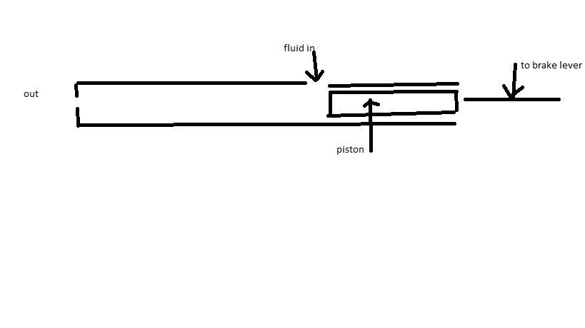

Postby DAVID THOMPSON » Mon Oct 19, 2015 9:54 pm
these are a beast to bleed
and the push rod from the lever to the pump piston can shut off new fluid from entering the pump if its pushing the piston in to far at the start of stroke
the piston must retract all the way
pressure does not happen till inlet is closed and it must open for new fluid to enter
CLUCK ON PIC TO SEE IT BIGGER

Re: 95 Skorpion Sport - a failed rear brake
Postby WaiNYC » Mon Oct 19, 2015 10:27 pm
DAVID THOMPSON wrote:these are a beast to bleed
David... I guess what you're saying is, we don't have enough info to determine whether any part is defective yet, and that the "slight oil leak" and shushing noise could be normal, and that I should check the bleeding procedure. Am I right?

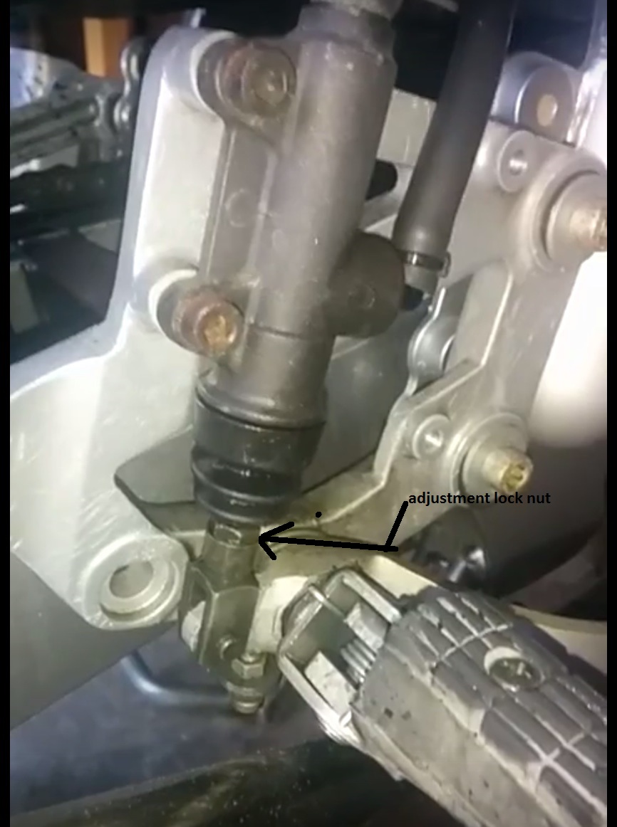

Postby DAVID THOMPSON » Tue Oct 20, 2015 2:26 am
the bleeding after checking if the pedal has no free travel
pedal may be to tight at rest and not letting fluid enter master cylinder
see comment in the picture
its a bit hard to see
CLICK ON PIC TO MAKE BIGGER
