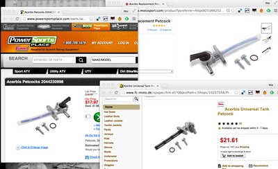

I wonder if having a different petcock would make a difference in my case. That's bec I found out about the remaining gas when the tank was already lifted from the frame, with the petcock removed, and I heard liquid splashing around inside. I really dont get this...

A simple Google search on Acerbis Universal Petcock shows products of slightly different designs. Which one do you use / will work on our Skorpions?

Not all images of products for sale show the actual product. The universal petcock has the valve 90 degrees off from the bolt pattern. I see it in two of the photos, the lower right, and as an alternate view in the above right web page. Just order the universal and you should get the correct product.
