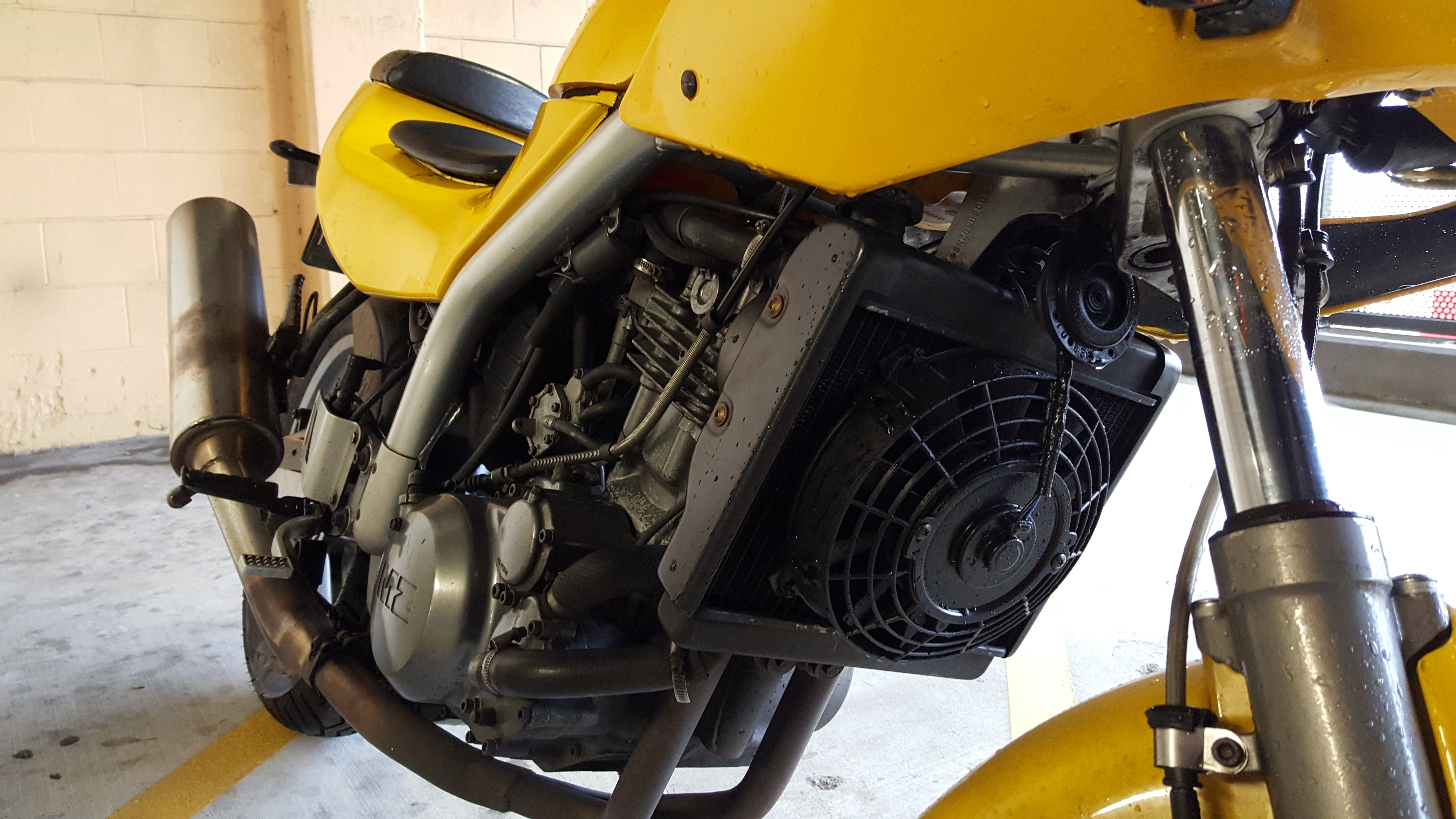

I was worried about mine as I noticed the bearings were buggered in the motors for them, the fan blades were just loose and rattled around. I use my sport to commute every day and get stuck in traffic sometimes so wanted to make sure this was sorted. I looked around for small replacement options and there were a few but I ended up getting a bigger 7" (I think) and mounting it in front of the radiator. This ended up costing me $25 instead of around $250. Just make sure its a fairly low profile unit so it doesn't foul the front guard on low suspension travel.
It looked a little ugly at first but I don't see it anymore and I know it does a good job when needed so its justified and as you can see its pretty hidden from a few meters back.
