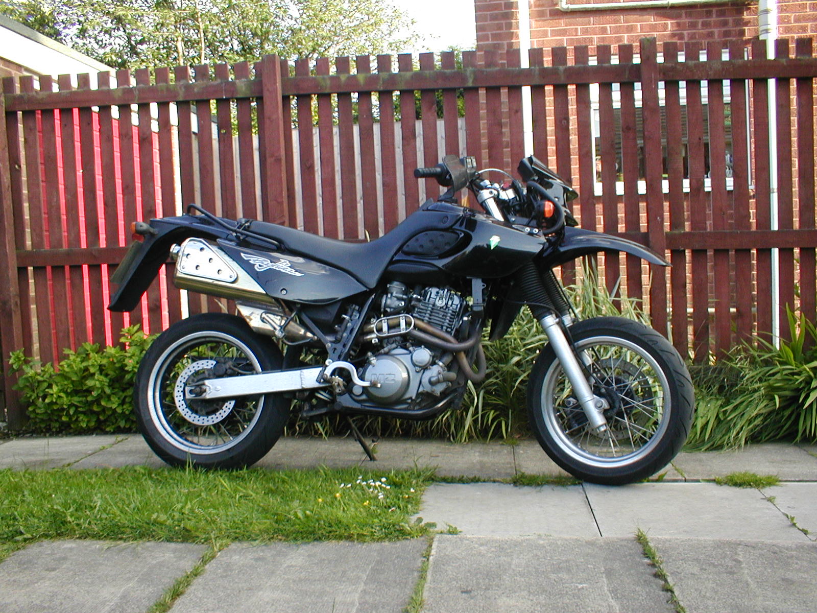

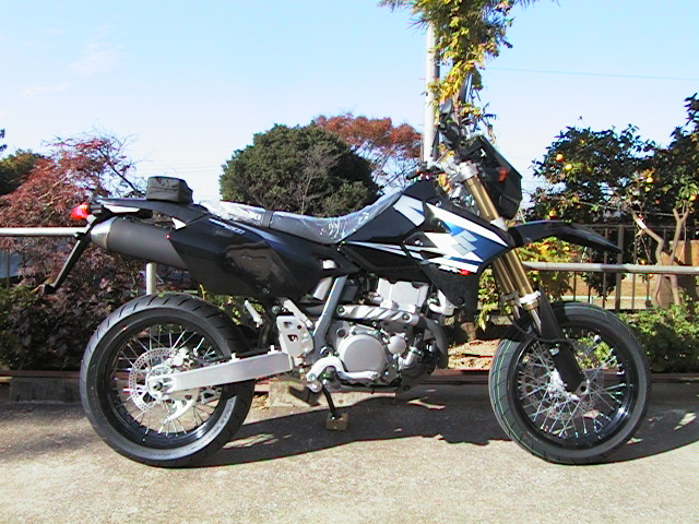

Postby TomLondon1978 » Tue Jun 14, 2005 3:31 pm
Is it possible to get some more sporty looking tyres on this bike as I really like the lower profile ones like on something like the DRZ400SM that Im also looking at.
See the pic for what I mean about tyres.

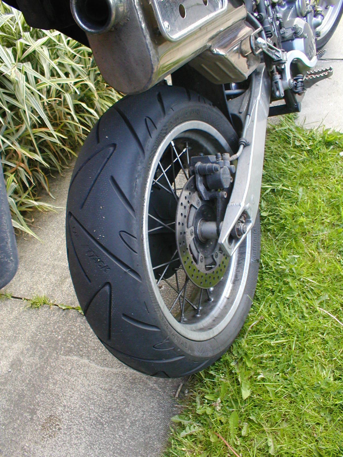

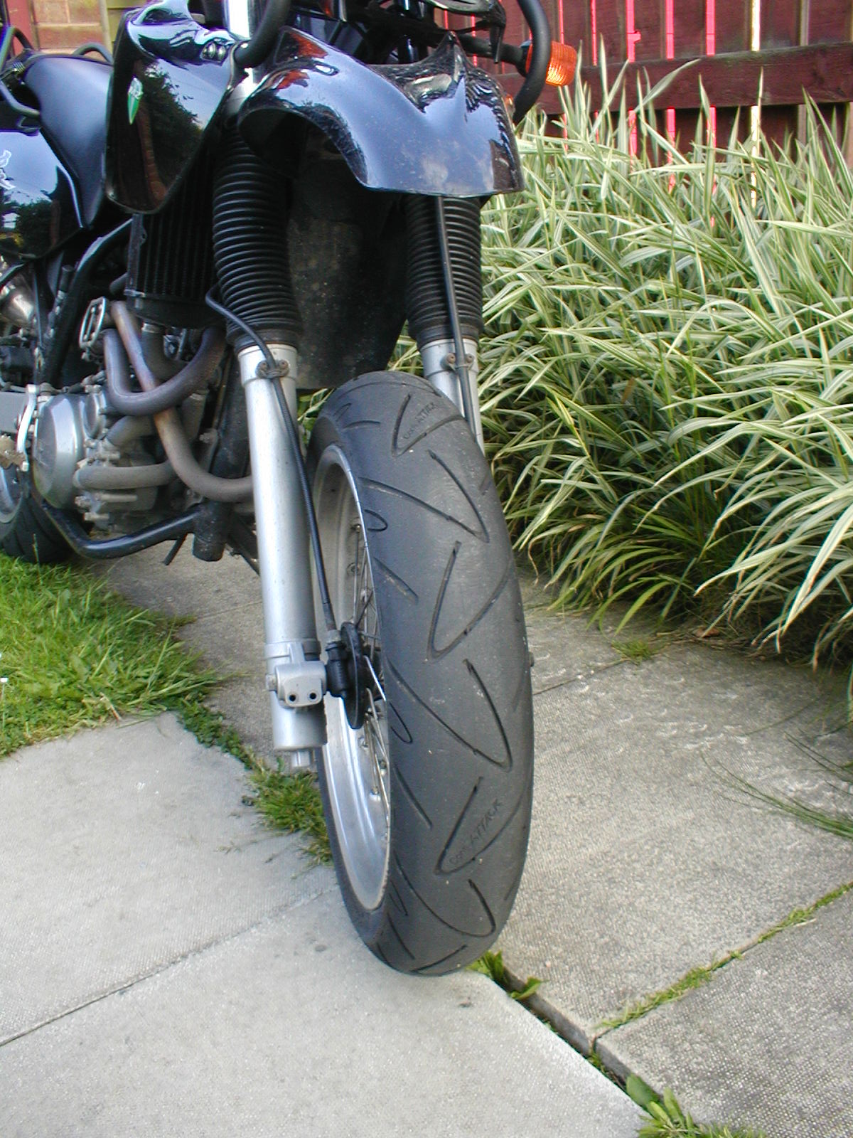

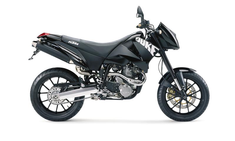

Postby TomLondon1978 » Tue Jun 14, 2005 3:52 pm
See what I mean by the tyres? Also the Duke ones look nice maybe could get those wheels and/or tyres on the baggy?

Postby keithcross » Tue Jun 14, 2005 6:52 pm
Tom
Check out any of the major tyre makers lists for the correct size tyres. The tyres shown on teh KTM photos can be used on teh baggi street moto and panther models.
For a real neat look, tryAvon Pro extreme rain tyres. Some rider I know also use proper race wets or even cut slicks on teh road, but teh police really dont like them if they catch you.

I changed both the origional tyres after about 3500 Miles (both badly worn at the edges)
Since fitting these Conti Attack tyres I've done about 500 Miles or so.
I went for these because they are supposed to last a bit longer, (they seem pretty good up to now).
There seems to be less rolling resistance. You can also flick it from side to side much faster. I haven't found there cornering limit yet!
Felt a bit funny at 1st, (I liked the slow laid back handling) but I now find these much better
I only use the bike on the road (commuting and playing at weekends)
They would be hopeless off road, No idea about track.
They cost about £160 for both fitted (pleased so far).

Postby boysie » Fri Jun 17, 2005 2:50 am
I hope your going to fit the axle clamp bolts to the lower fork leg before you ride it :shock:
