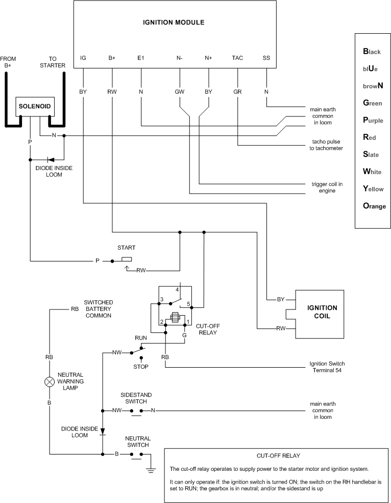

So went for a ride and all of a sudden the neutral light stopped working. Wasn't doing anything other than the usual road riding. No thrashing just a quick ride.
Has anyone else had this problem. Where should i begin working it out? just thought if anyone knows if its something simple?

check the bulb then
we are into bad diodes in the wiring harness
or the neutral switch
download and print this (thanks to tony idle)
click on it to see it bigger

hi there,
check the wire (blue) from the panel light to the switch is OK, neutral switch is just to the left of the primary sprocket. I found this wire pinched through as it enters the engine casing just above the primary sprocket. so needed to fit a new length of wire to make it work again.
