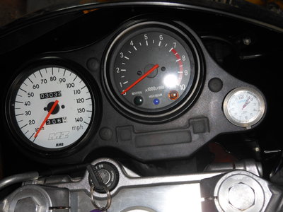

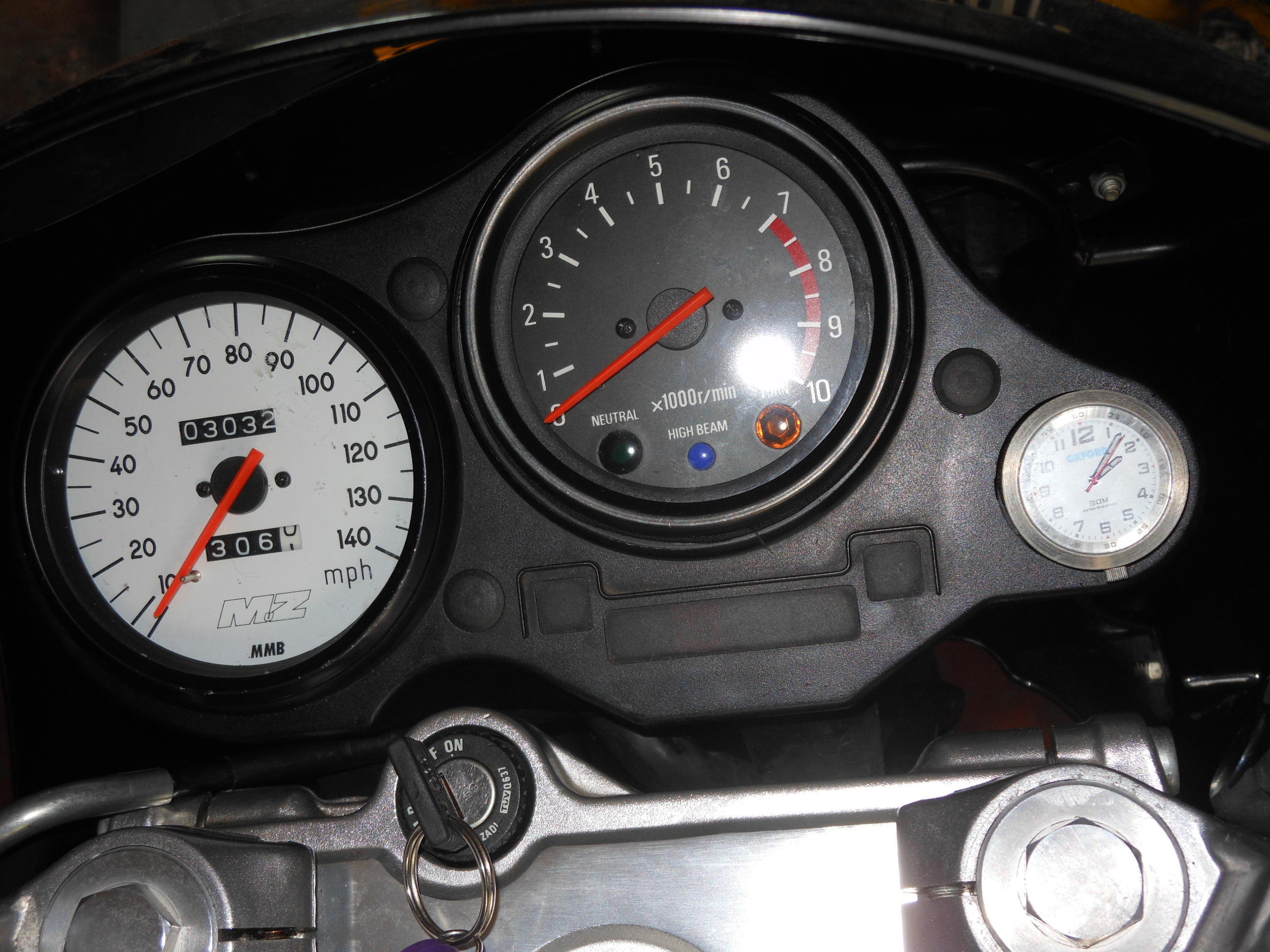

Just an update, Nils.....it read smoothly when on the side stand but after taking it for a run it was just as bad as ever. So I opted for a mechanical tacho from the SR500, using a XTZ660 drive and cable , I also transferred the needle from the MZ one to the SR500 tacho to make it look similar, the SR500 tacho has a black face and looks quite nice with the white face speedo
