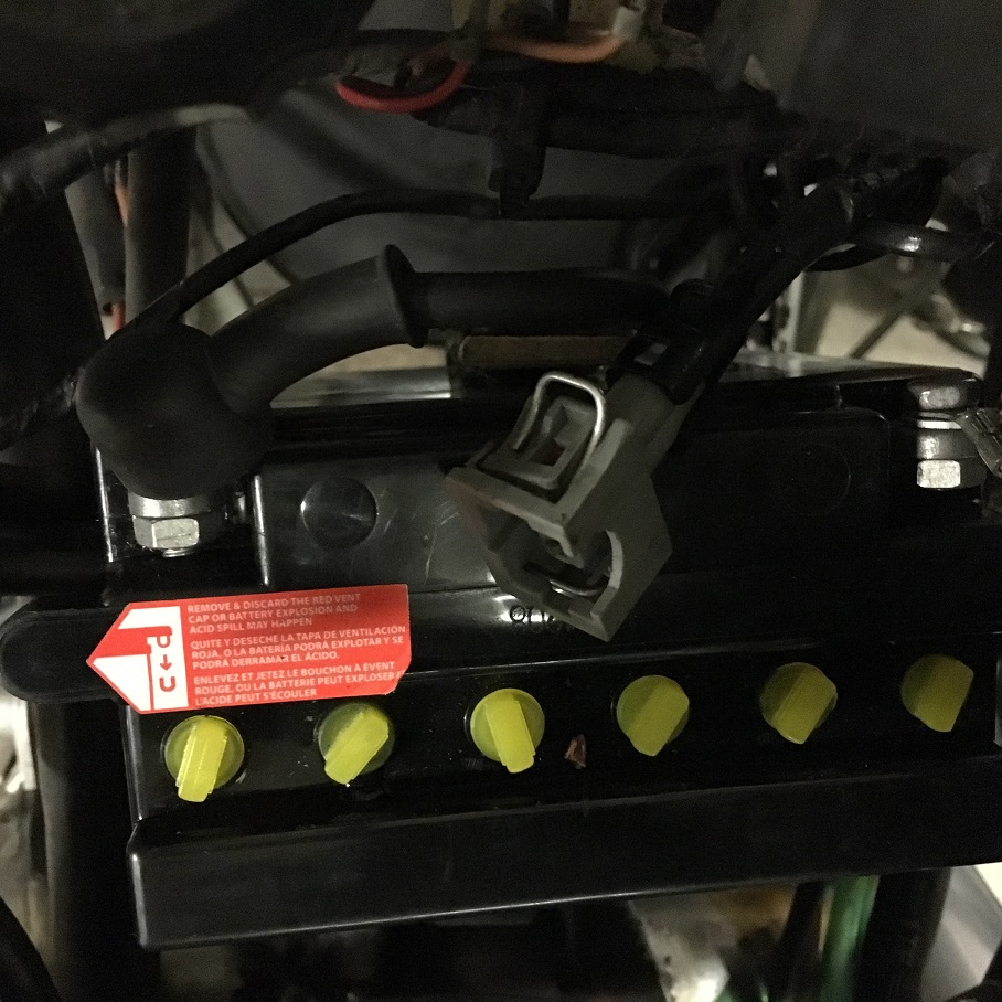

I have a new-to-me Skorpion Traveller that I am trying to sort through a wiring kludge that some unknown number of previous owners have created. I have managed to pull out and disconnect the aftermarket accessories and, with the help of the wiring diagrams and other documents I've found here am trying to get to an original starting point. The diagram shows a large battery lead from the positive post to the starter solenoid, which I have. It also shows a smaller black wire that goes from that post to the 7A fuse, which I don't see. In the area of the battery and the starter solenoid I have a grey connector that I haven't been able to find any matching end for, which is visible in the attached picture.
My initial questions are, since I am sure there will be more, what wire should I be looking for to go from the positive terminal and the fuse box, and what should that grey connector tie to?

edfmaniac wrote:The connector that has nowhere to go was also on my Traveller. Don't remember what it was for but it must be factory.
That is attached to an electronic valve on my Traveller. Hooked into the currently "non-existant" smog harness...(I have all that stuff in a box...JIC...)
It is a switched power line. I'm using it now for the power tap on my chain oiler.
