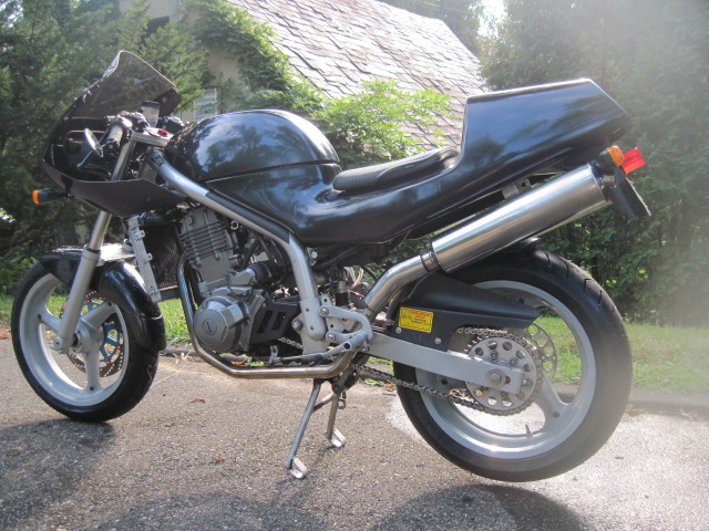

some wheel pictures!

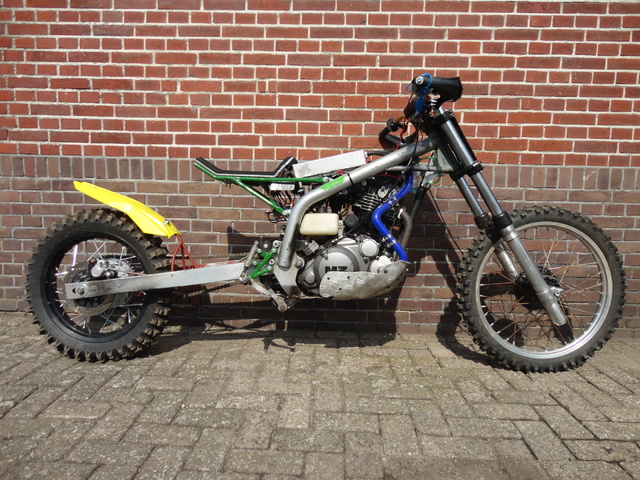

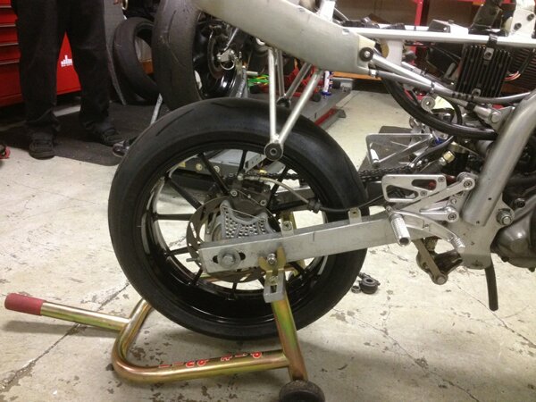

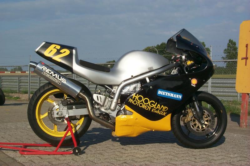

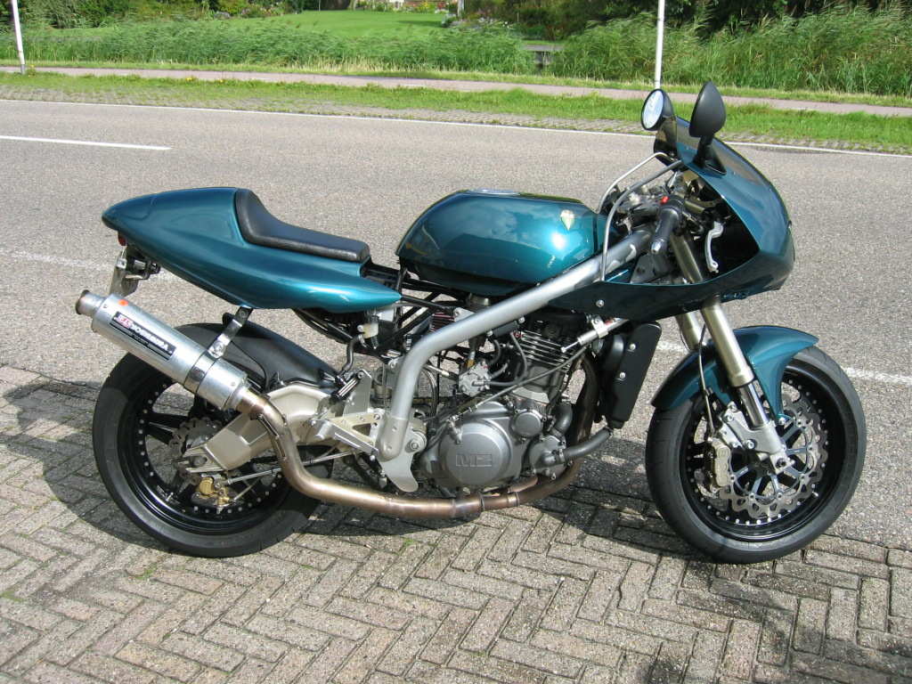

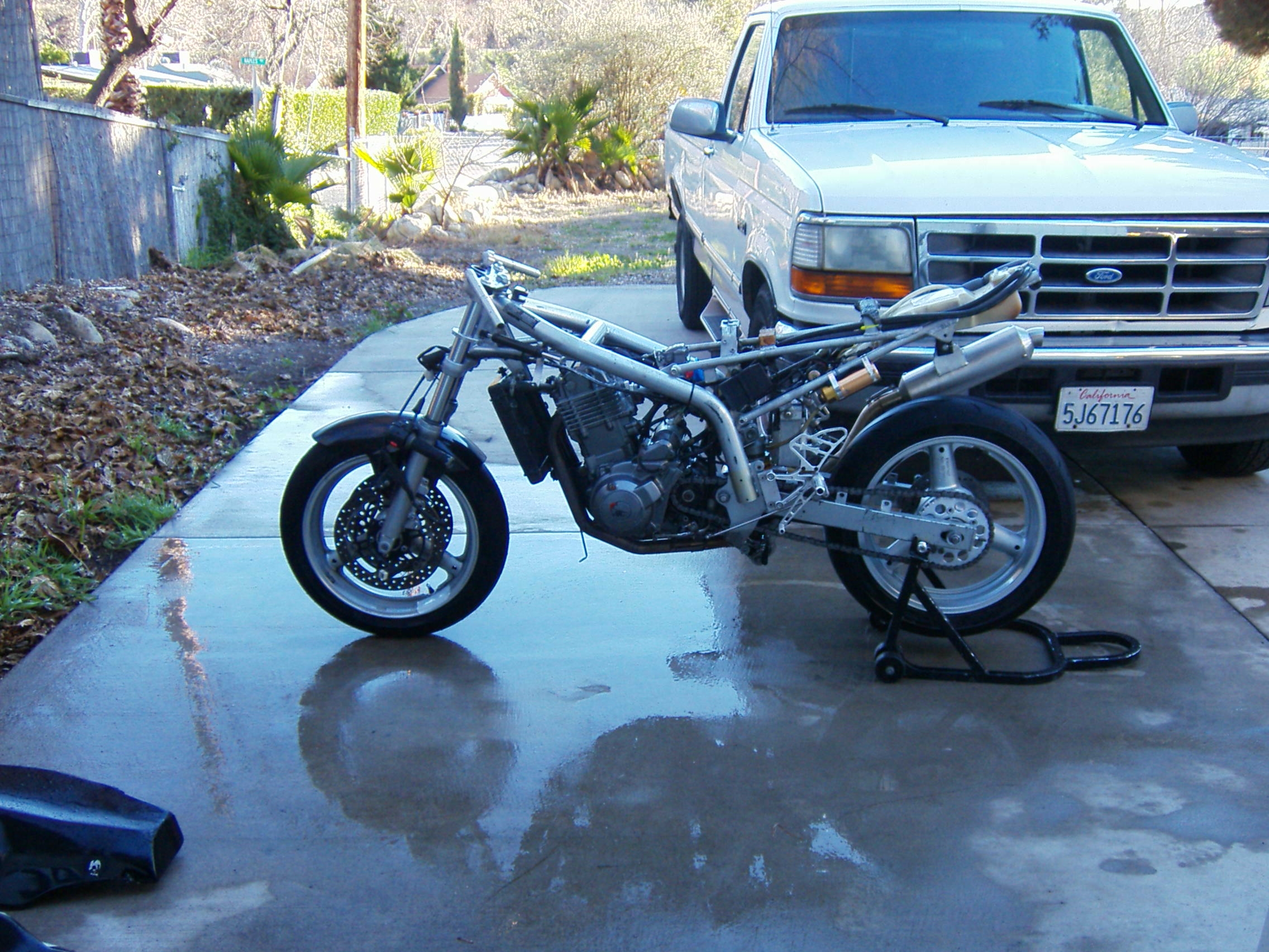

That's the SV in the middle
Some other pictures - I'm not sure of the wheel types :D
