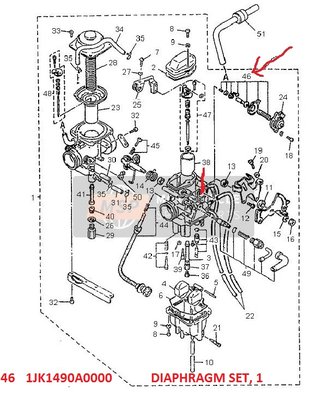

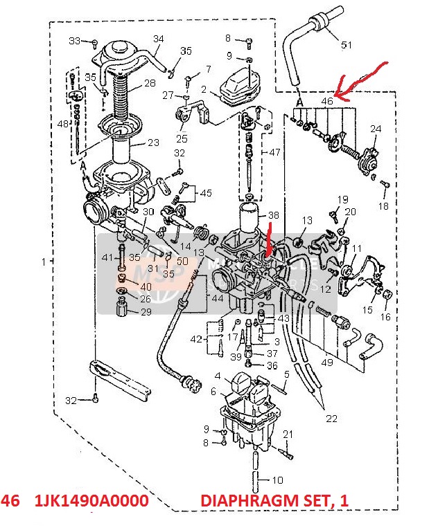

Postby dandywarhol » Sat Jul 23, 2016 5:48 pm
Check item number 46, diaphragm, isn't perished with ethanol/age. It's an anti popping valve :D
https://www.motorcyclespareparts.eu/yam ... 43944.aspx

Postby DAVID THOMPSON » Sat Jul 23, 2016 9:24 pm
posted this in case link goes dead
click to make it bigger
Re: Popping & Banging on the Overrun
Postby starfield181 » Sun Jul 24, 2016 4:58 am
I wound the pilot adjuster screw out. Probably about 4 turns in total now and the popping & banging was much reduced. The tickover also speeded up a bit so. I will try another 1/2 turn out to see if it continues to improve.
Interesting concept of an anti popping valve. Wonder how its supposed to work. Looks as though you have to buy the whole assembly rather than just the diaphragm. Think I will continue with adjustments for the moment. Bike is certainly much better now.
