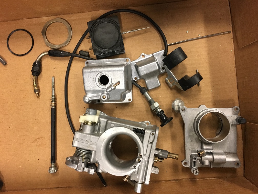

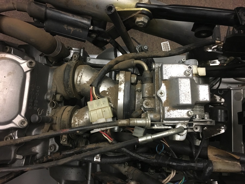

I managed to get the tank off with plenty of twisting, pulling and prying along with an appropriate level of verbal abuse. As Dave recommended I left the horseshoe bracket attached to the tank. With it out of the way I removed the K&N Air cleaner and was met with a glop of Foreign Object Debris inside the carb bell. The carb turned out to be a Mikuni flat side unit of unknown origin, at least as of this point. The air cleaner was on tight and appears to be intact with no holes or tears so I don't know how the gunk got there. I haven't taken the carb off or gotten any deeper so I don't know how it looks inside yet.
If it eventually runs well enough with this setup I will probably stay with it rather than try to hunt down an original carb and airbox. I am including a couple pictures of what I have now. I am sure I will have more questions as time goes on. Thanks in advance for any help or suggestions.

Postby DAVID THOMPSON » Sun Nov 20, 2016 4:39 pm
stay with the carb thats there and sort it out...
the originals are a pain
Re: Troubled Traveller update
Postby droy » Sun Nov 20, 2016 8:05 pm
Thats a single carb conversion that was done by Bikewoks (Galen) - rare piece.

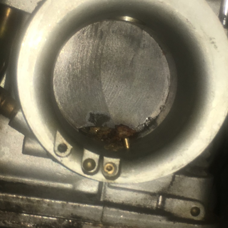

So, here's what has been happening with my Skorpion.
As I mentioned earlier, I have not real history or experience with this bike. When I got the Mikuni carb off and broke it open I could guess that it had been sitting for a very long time. It was the worst mess I had ever seen in any carb.
-Jim

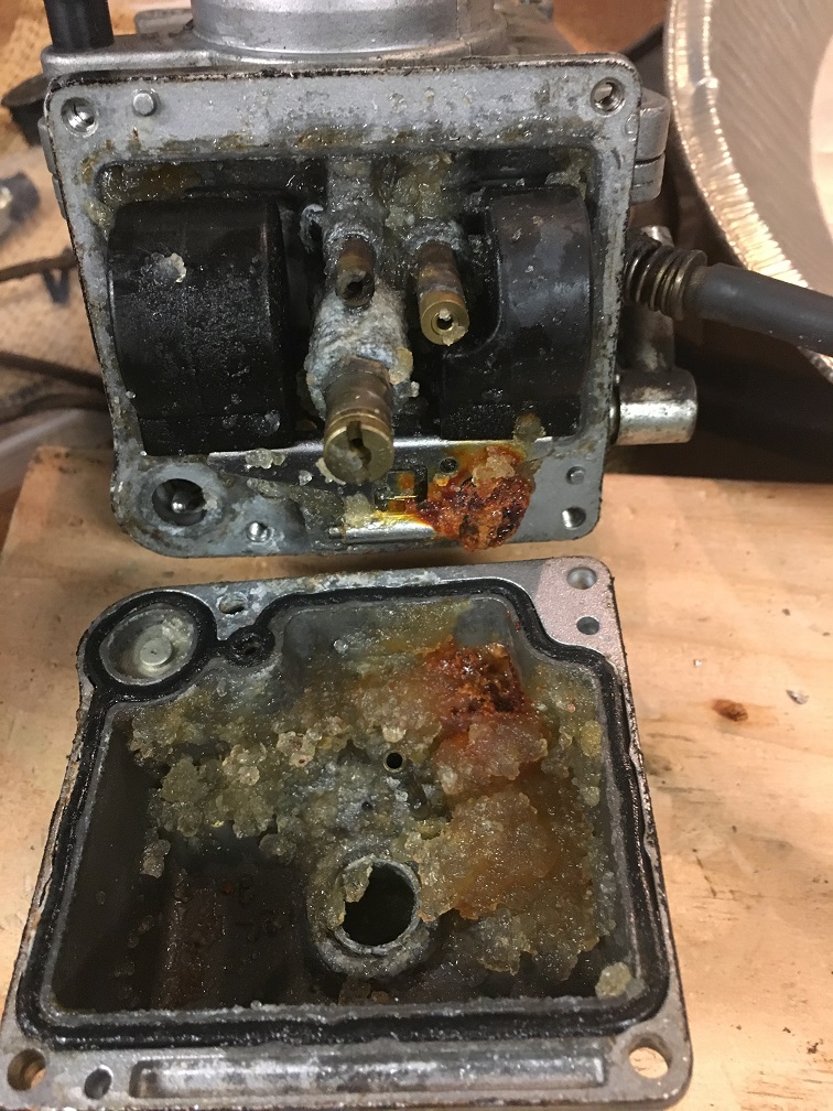

Postby fxaz » Thu Dec 08, 2016 9:27 pm
With a heavy application of nasty chemicals, elbow grease and time, I was able to find a carb under all that mess.
-Jim

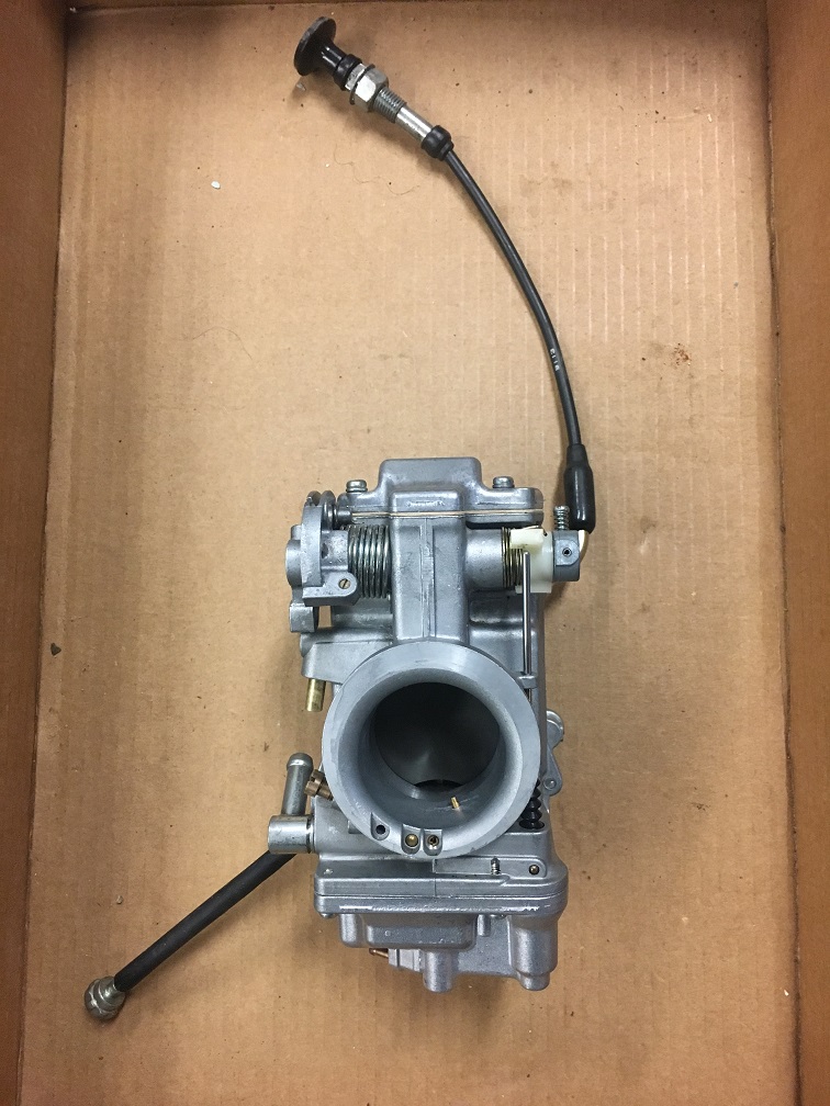

Postby fxaz » Thu Dec 08, 2016 9:29 pm
And finally, I was able to put in a new Mikuni rebuild kit and get things back together.
Next step is to get it put on the bike and see how it works.

Postby DAVID THOMPSON » Thu Dec 08, 2016 10:55 pm
that was a lot of work ...looks nice

Postby billr » Tue Dec 13, 2016 5:35 pm
fxaz wrote:So, here's what has been happening with my Skorpion.
-Jim
Now that was just NASTY. Never saw one like that and we had some old farm equipment that could make a huge mess if left to lay around.
It did clean up pretty, though.
