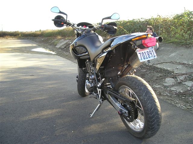

I have $25.00 in my tail mod.
Picture 023.jpg (65.34 KiB) Viewed 4330 times

I trimmed the rear mudflap all the way up to the brake lamp, then I moved the whole thing in to make it almost flush with the fender.
I cut and re-welded the license plate bracket so that it is at 90 deg to the fender.

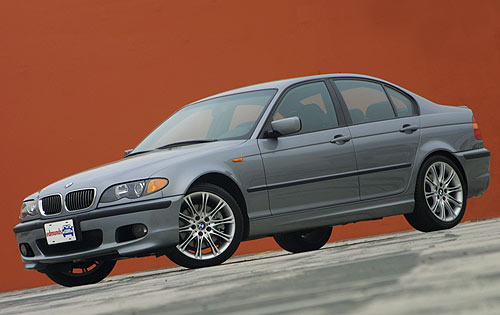

the turn signals are 02 or 03 BMW front fender repeaters, they have them for $12 or $13 each, and they come in clear and amber. they just clip into the fender sheet metal, so I made a "V" bracket out of sheet metal and riveted it in place. the lenses just clip into the "V" bracket.

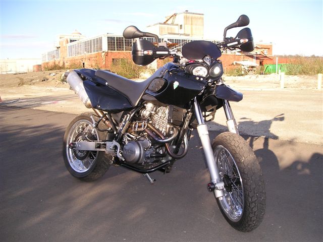

my front turn signals are mounted on the hand guards, and I eliminated all the stock front light and bar set, and run an Acerbis front headlamp with a HID bulb.
Picture 020.jpg (55.31 KiB) Viewed 4299 times
Picture 022.jpg (59.06 KiB) Viewed 4299 times

Postby phlat65 » Sun Jun 26, 2005 11:48 pm
they are 03 BMW 3 series (car)
side markers (on the front fender) they usually have them in stock.

Postby phlat65 » Sun Jun 26, 2005 11:54 pm
here is a 330 with them on the front fender..
