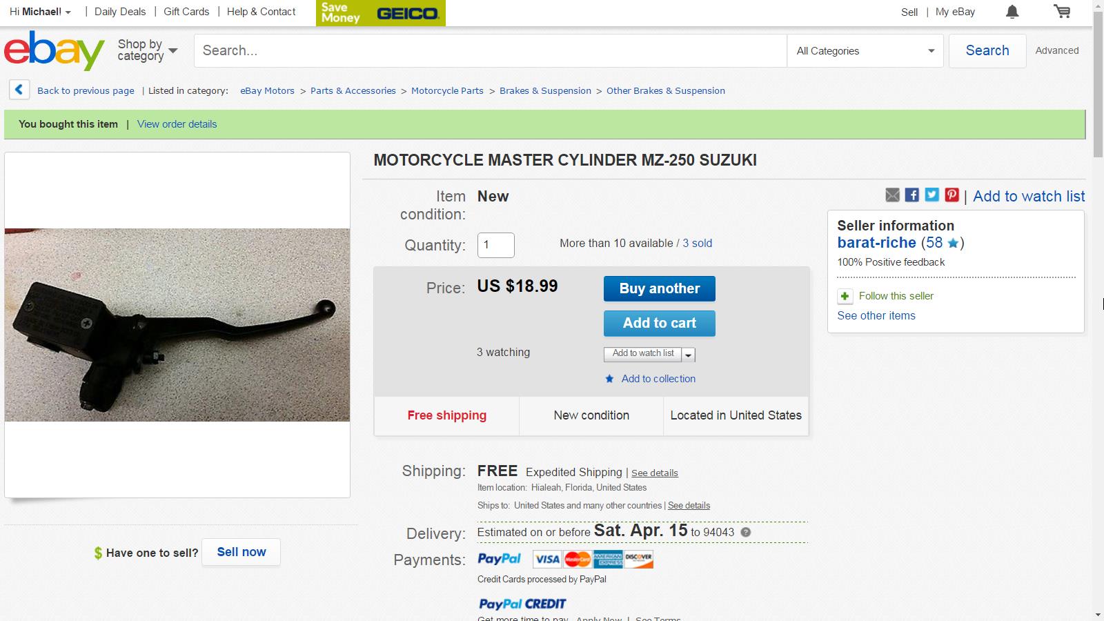

I decided to look for a used MC on ebay so I could experiment on rebuilding it, when late one night, I came across this listing:
http://www.ebay.com/itm/121711053751
In case that listing is no longer valid, here's a screenshot:
If you think the caption is unhelpful in figuring out this MC's details, here's the entire description: "New Brand Motorcycle master cylinder for MZ-250 and Suzuki. Excellent quality. Not accepted returns. Thank you." Now, I know less than nothing about MZ 250s, so I had no idea if it truly was an appropriate MC for that bike. I'm not even sure which MZ 250 it's supposed to fit, though I assume that it's the ETZ. However, I couldn't help but notice that it looked IDENTICAL to the Baggie rig - lever and all.
Of course, only a moron would order a non-returnable part from ebay just because it looks like the right part. But that price, tho. Nineteen bucks and free shipping. It kind of would be worth it to just take a flyer. I've spent more on dumber things. So I decided to take a shot.

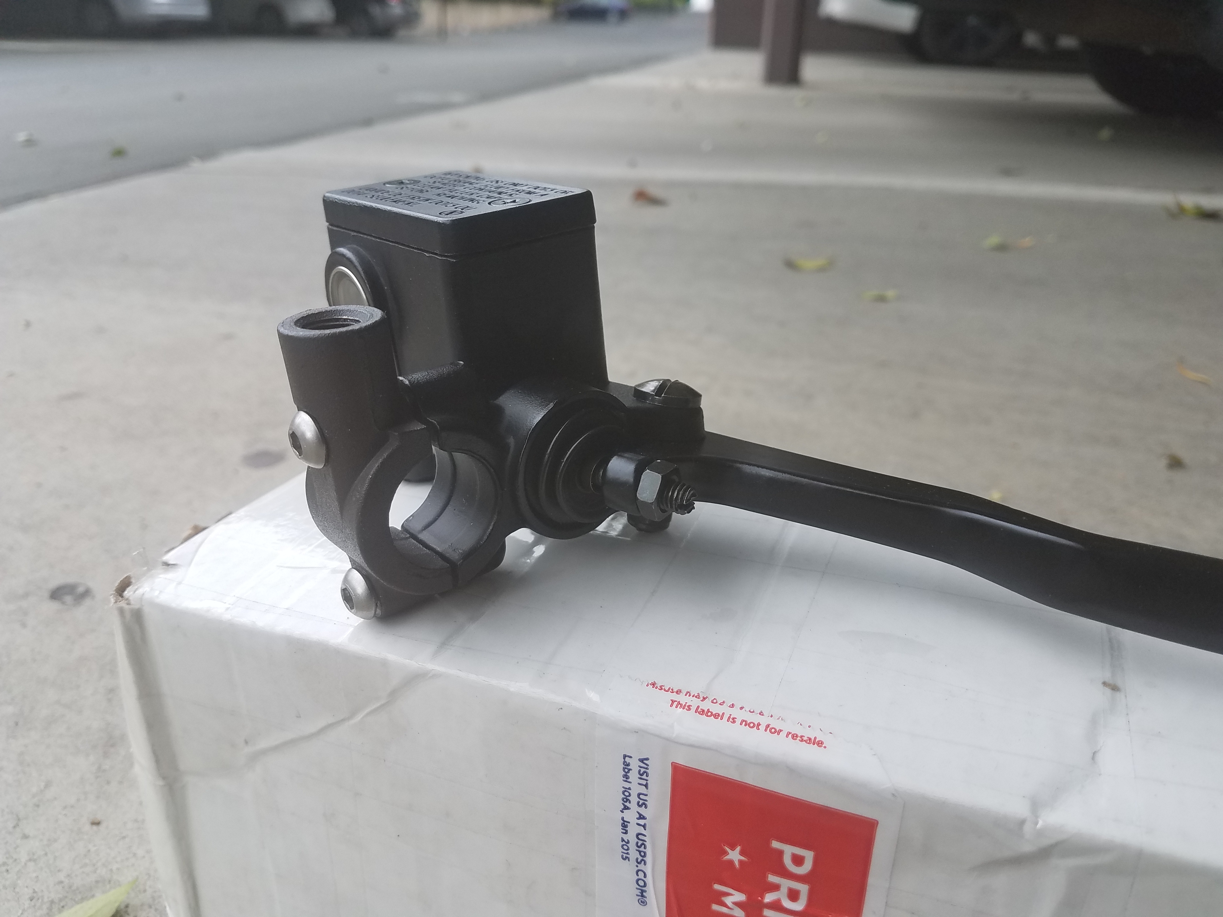

My surprise was more than pleasant. Short of sawing them both in half and measuring the internal dimensions, I would swear that this is a 100% exact match for the stock Baggie master cylinder. There was, of course, one small structural difference:

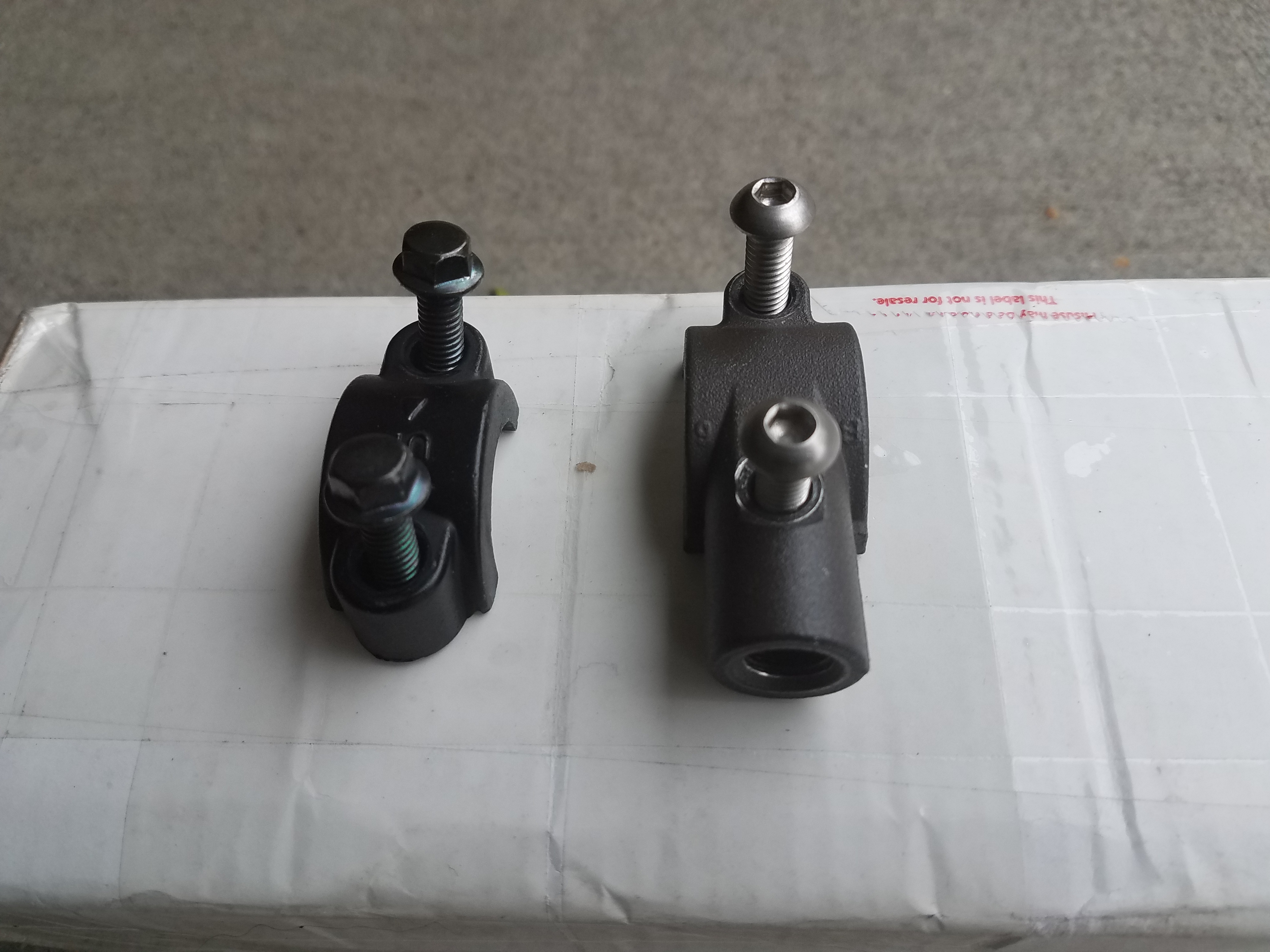

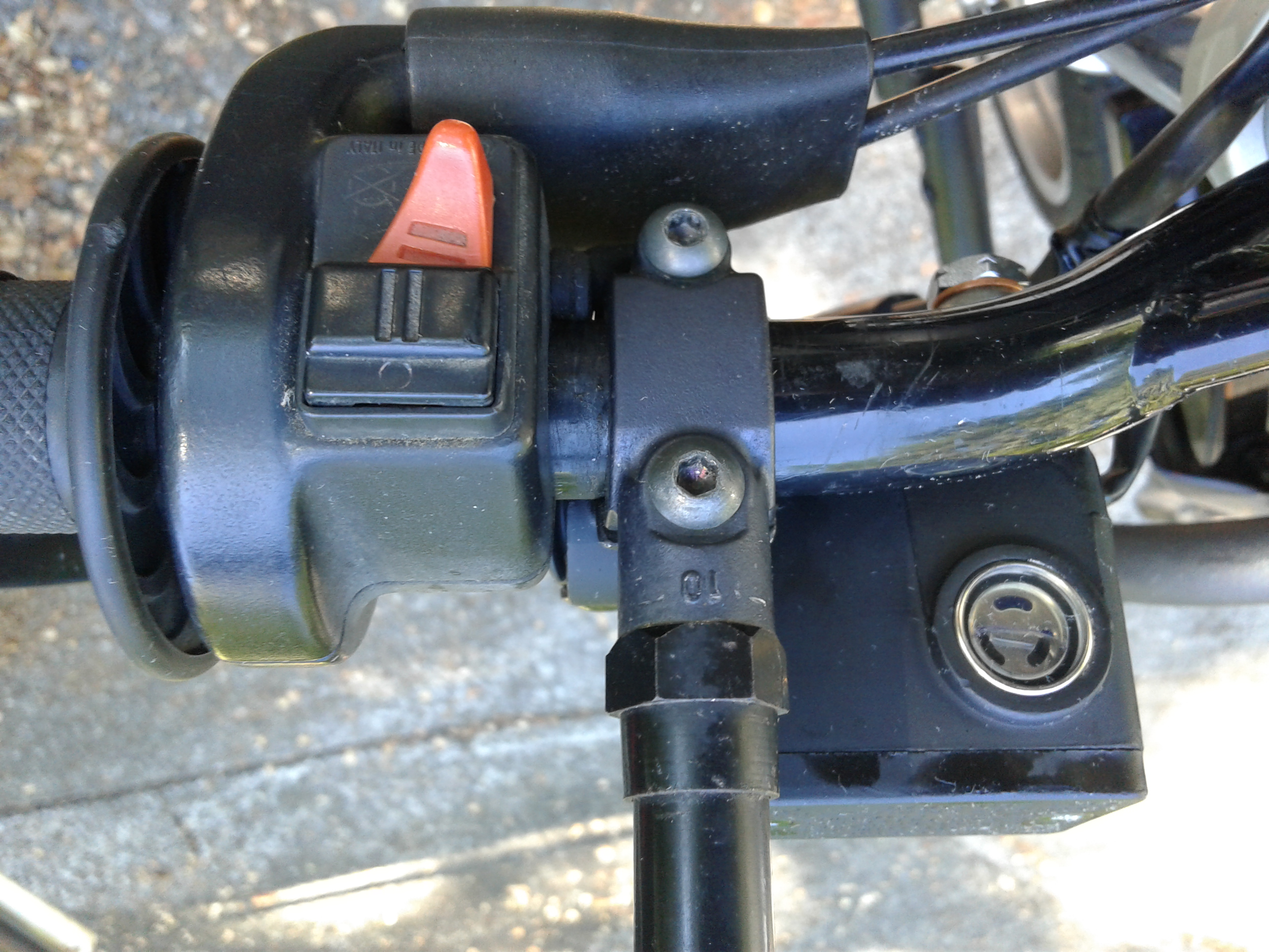

I guess the ETZ250 mounts its mirrors elsewhere. But lookie here, the stock Baggie mirror mount bolts right up.
And of course, this one is black, instead of the custom faded grey of my MC and mirror mounts (Stop judging me. I had to park my bike on a covered porch for a couple of years. In the antiques game, they call that "patina."). Small price to pay, as far as I'm concerned.

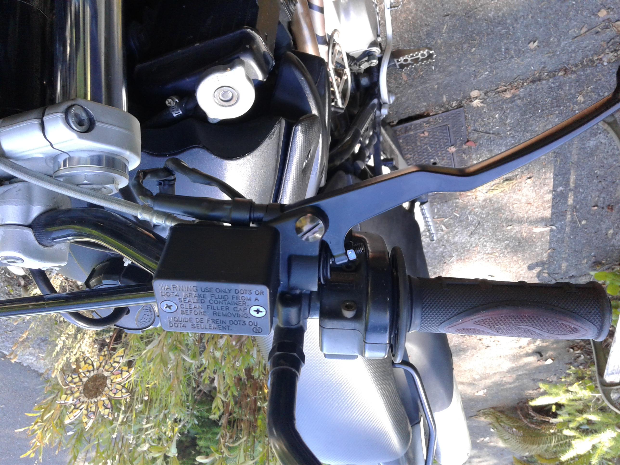

Bolted on the MC, hooked it up, traded out the lever, which is also identical, for my old one (because I cut it down for handguards), bleed, bleed, bleed, sew it up.
Short term testing shows that the front brake is now as stiff and effective as the day I rode the Baggie out of the showroom. A little too effective for someone who's been riding with the deteriroratinng MC for a few years, if you know what I mean. Of course, it's still the stock set-up. I'm sure you can get way better performance out of a new Brembo master cylinder with a custom fabricated bracket to fit a four pot caliper. But for me, who was just fine with the front brake as built, this solution was a godsend.
