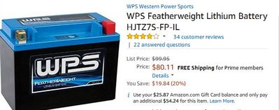

In July I purchased a new battery for my Baghira. I went with a LiOn because I'm sick of having a dead battery every spring and refuse to let a battery sit charging unattended. The battery feels like it weighs next to nothing.
It now 09/06/2017 and the battery has had no issues.

If the bike has a slow turnover in cold weather, these batteries need a little time to warm themselves up and put out full voltage. I have a method that gets mine started every time. Crank for about 5 seconds and then let battery rest for about 30 seconds. It should get stronger and stronger as the battery warms up until the bike turns over fast enough to start. Should be fine the rest of the day. This only happens to my bike if it's below 60 and it's been sitting for more than a few days. Some manufacturers don't recommend using the starter to wake the battery up but I've had no issues. You could also just turn the headlight on a few minutes before you want to start the bike but it's quicker with the big amp draw of the starter.

After a quick look it appears we would pay about twice your US price here in the UK.
I`ll stick with my old fashioned lead/acid technology i think. :)

I will keep that in mind, but I will be parking it in the garage as soon as the rain returns. Big plans for some upgrades,
