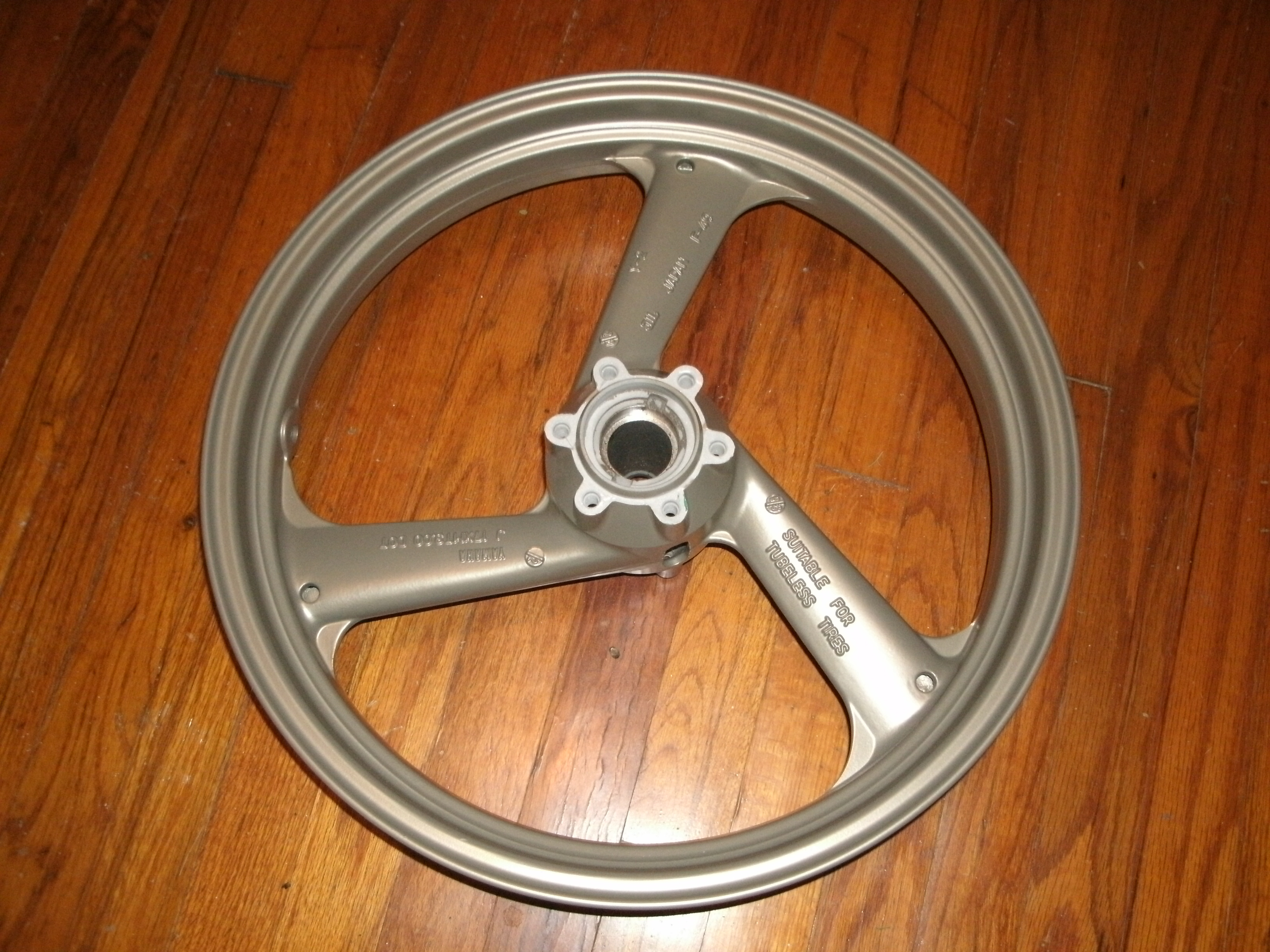

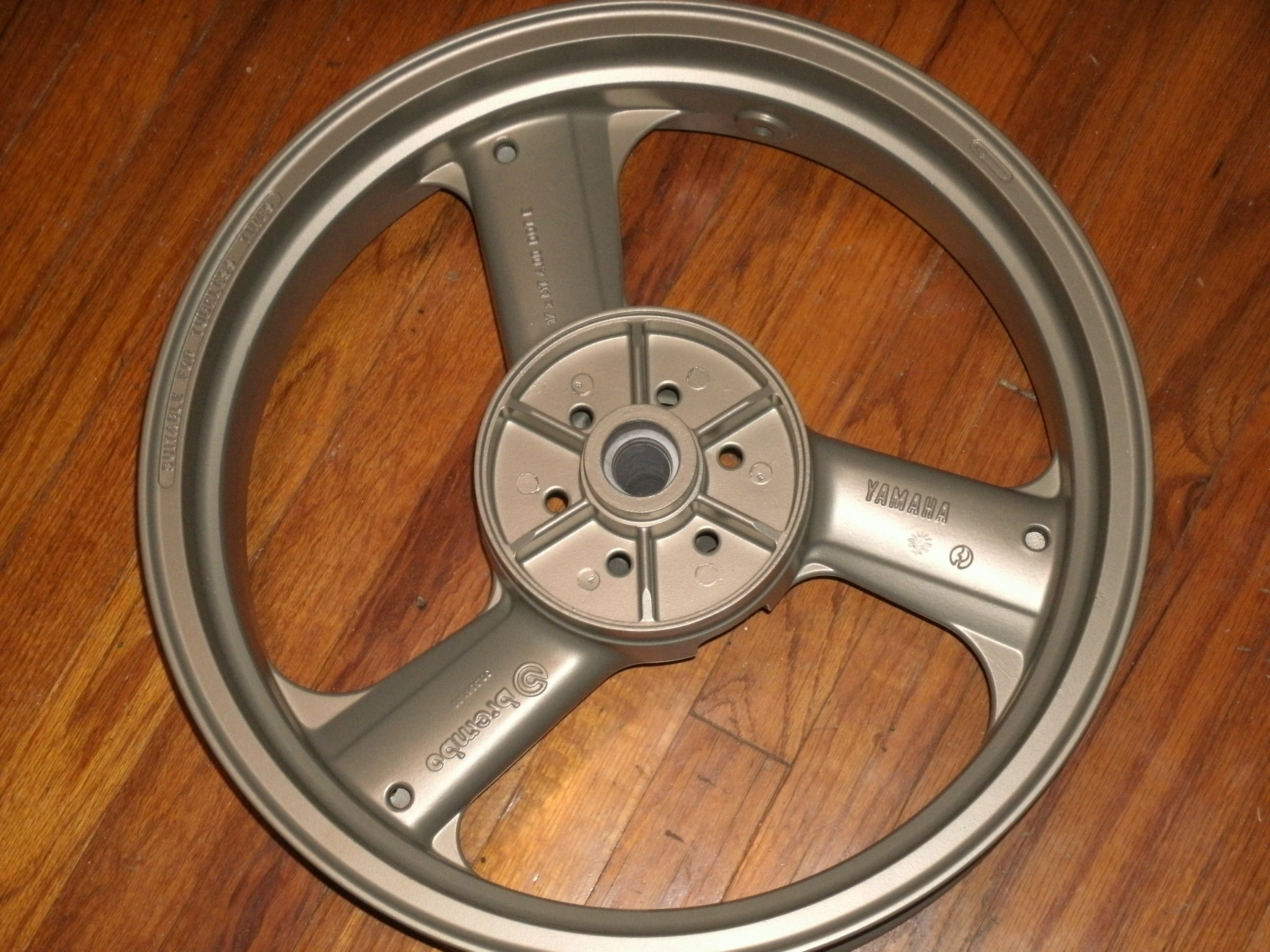

The only wheel swap I've seen specs published for is the SZR 660 swap. They can be hard to find but are light and easily mounted on the Skorpion swing arm with the addition of the SZR caliper mounting plate and a little machining. The front also fits the Skorp with even less modification, just a wheel spacer. Add some Ractech valves to the stock forks and you are good to go. :D

I'm pretty sure the TZR wheels were the ones I was talking about when I said there was another model bike that had the same wheels as the SZR. I'll have to hunt down the post on here but there is one about those wheels.
As for the SV650 wheels, I have little doubt that it can be done, but how much do you have to modify? Do you have to machine the wheel, the cush drive/sprocket carrier and make your own spacers, or is it minimal work like with the 4DL wheels? I've also seen KTM 690 wheels on a Skorp. Was originally going to buy forged Marchesinis for my project bike until reality sank in. LOL Too much money. So I just found the Brembo set from the SZR and had them powder coated.
