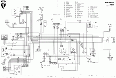

CLICK ON PIC TO MAKE IT BIGGER
relay 19 carrys it all
Note: This is for the Baggy. Probably going to differ from the Skorpion diagram. :)

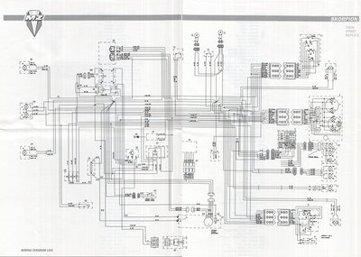

Here's one from an old thread on this site called "Wiring Diagram". I found it by Googling "mz skorpion wiring schematic". ;)

Postby DAVID THOMPSON » Fri May 25, 2018 9:33 am
the main relay number is different rt125 drawings calls it 19 some 660 drawigs call it 30 others call it 21
it carries all the current and is not big enough over time so it dies
21 on above is the spark coil
and the drawings are reversed sides look where the tail lamps are on the two drawings
