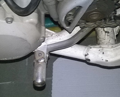

Postby rd400racer » Tue Sep 17, 2019 6:44 am
Puffs wrote:OK, forget what I said, language problem. Seems you're talking about what I would call the gear shift lever, and looking at pics it's a rear-set special item.
Here you go...this is what it looks like:

Postby Puffs » Wed Sep 18, 2019 4:33 am
Right. Sure looks like alu to me.
This is why many MX bikes have a flexible joint there:
Gear shift lever YZ.jpg (33.95 KiB) Viewed 2886 times
Anyway, I'd just bend it back. First take the thing off the bike, take off the rubber, then heat up w/ a torch & gently bend. Or leave as-is, not really a biggie.

Postby lavrentyuk » Wed Sep 18, 2019 11:40 am
As stated - I'd probably leave it as is as it shouldn't affect the ride - or take the risk of gentle heat and bend. Of course this might damage the finish and does risk you breaking it or weakening it.

Postby rd400racer » Thu Sep 19, 2019 6:50 am
Thanks all for the advice. One of the fellow members has a foot lever on its way to me right now. I did take the bike for a quick test ride last night and no, the lever isn't that bad. But considering that I'm going to take this bike, which I've never ridden except down my street, to race on a track that I've never been to before...well, I kind of want everything to be totally comfortable. But it's getting there. The R11 Bridgestones should be an amazing tire.
