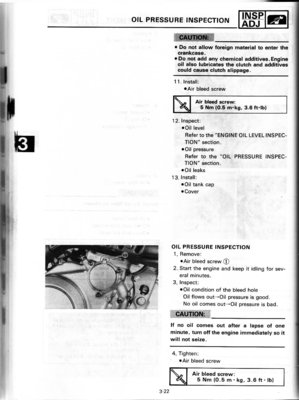

Postby Puffs » Wed May 20, 2020 3:50 am
handsomejackuk wrote:
what are the options for oil pressure switch ?
I looked up that oil pressure for you, the XT600 book says
so if the 660 is same, that's not very useful. Indeed, very low pressure, at least there.
