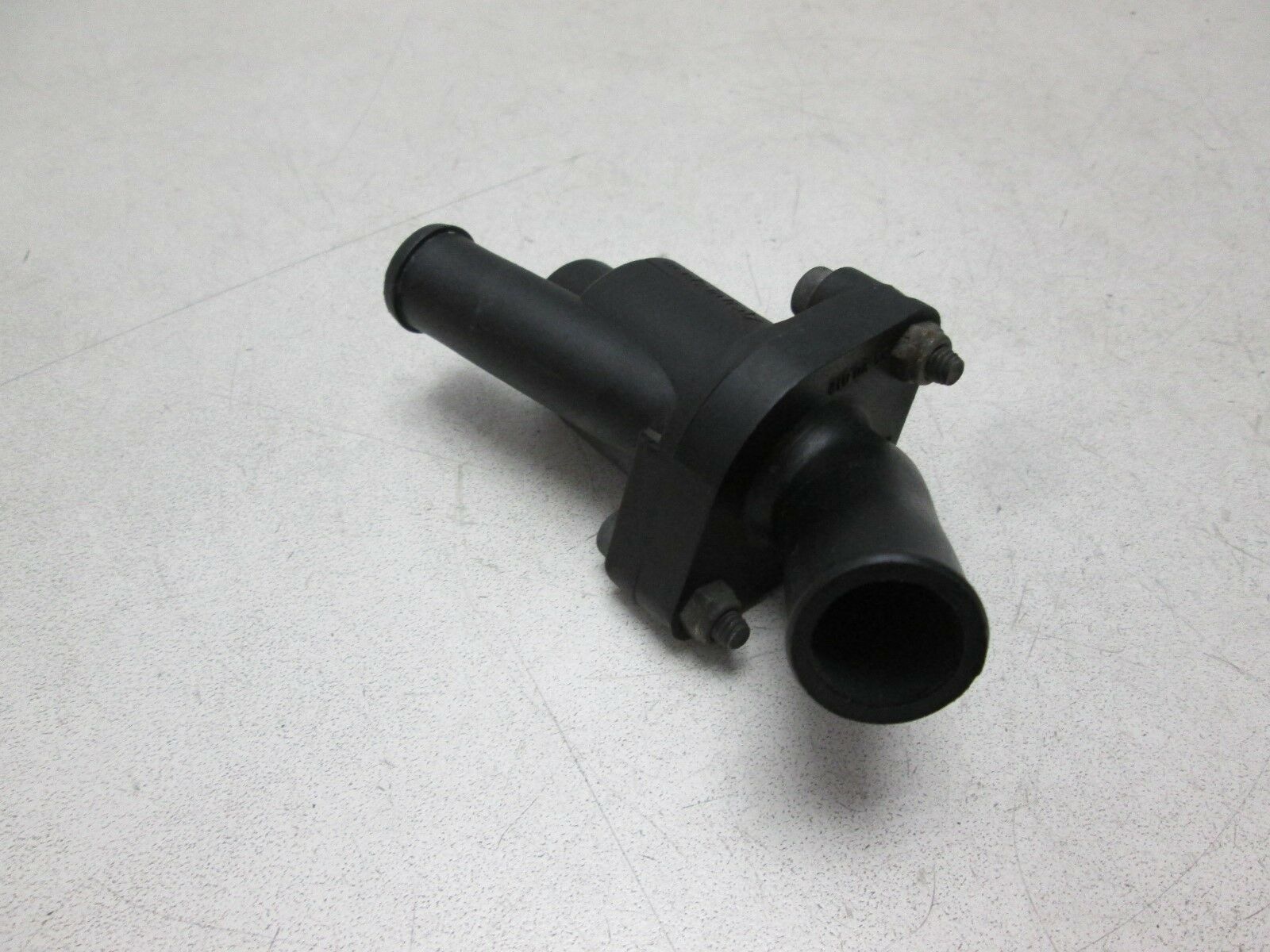

Hi.
Has anyone ever taken the original thermostat apart or know how it works? I quite fancy replacing it with a proper one that cuts off flow to the radiators entirely until the engine gets up to temperature which i`m sure the original one can`t do. What sort of setup does the Scorpion have?

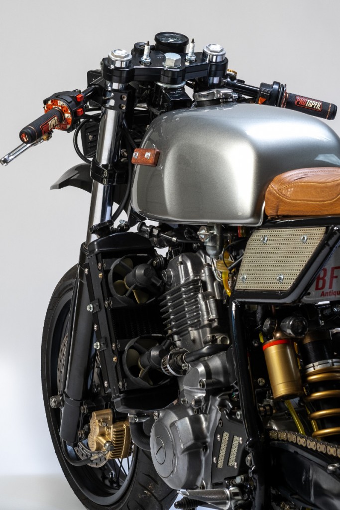

This Baghira has only a single radiator -
http://www.bikebound.com/2019/10/24/mz-baghira/
