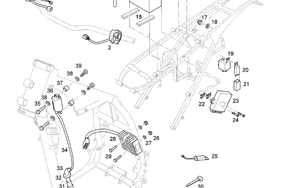

anyone know where the ignition module is on a baghira or mastiff, same bike ?
i cant think where it can be i thought it was the module above the sidestand but thats the voltage regulator....
Anyone ?
It is number 23
