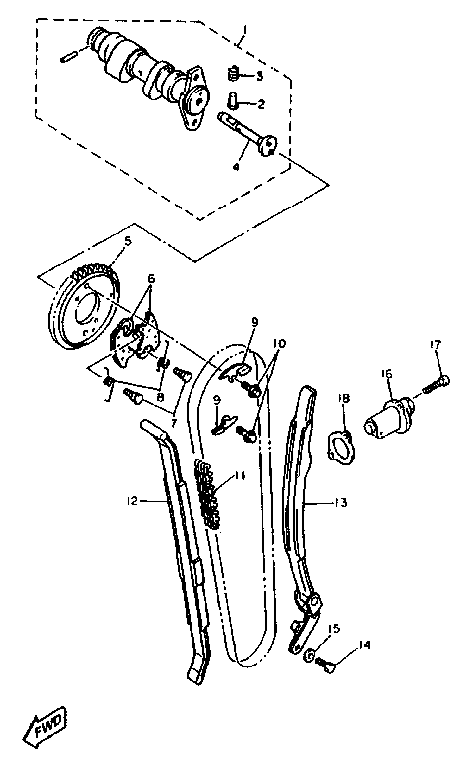

Postby Puffs » Mon Oct 12, 2020 5:30 am
The give-away is if your tensioner 16 is at the end of it's range.
Chain clatter, when you move the crankshaft forward/backward?
When you have the thing open, the book will also specify a maximum length for a set number of links.
