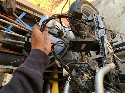

Postby funmonkee » Sun Jan 23, 2022 2:56 pm
I've had this yellow 2003 for a couple of years.,,actually 3 years, pre COVID...
Just getting around to cleaning it up.
Done the wheels. new discs, chain and sprockets, got some replacement panels. Decided to start it up and had to remove the battery to charge that...
wow what a mess!
It was never great, but once the battery came out it just looks the pits.. . .:-(
I'm using as much internet resources as I can to try to tidy this up. for example the diagrams on https://grahamsmotorcycles.com/mz-parts ... l-devices/ have helped with part numbers. But pretty much knackered with the electrics. it's been hacked about so much.
So,
what would help me, is for any close up photos of under the seat electrics. showing me the difference to this mess ...

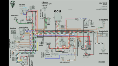

link below
and more by doing a site search for tony idle
he did some fine drawings of the wiring system
and relay 19 and relay 30 its the main relay on the 4 cycle 660 and 125
cc bikes
for color coded wires to repair with visit a late model German car a a local parts breaker
crimp connectors suck solder them on the wire
the school system has failed to teach BASIC electrical skills world wide the word mess is what you see under the seat
of most bikes
viewtopic.php?f=3&t=8130&p=42882&hilit=tony+idle&sid=a95da366f11e102ea455a8c4d5f464d9#p42882

I've spent a fair bit to get this bike clean and almost ready for the road. If I'd looked at the battery and electrics first, I would have given up at the start.
Just not sure where to start. The headlight works; clock lights, for headlight on and full bean work. The indicators are dead. The rear tail light is on; but no activity when I use the rear or front brake.
With a fairly new battery attached; it tries to turn over. There is fuel will need to get the plug out and see what state it's in.

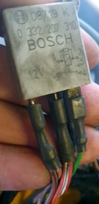

looking to confirm which component this is on the attached... electrics schema
Which relay is this ?

Postby DAVID THOMPSON » Wed Jan 26, 2022 10:16 pm
the green wire gives it away its relay right in the lower middle
of the wires drawing and carries every thing it is relay 19
when it closes at power on the red black and red white get connected
and the bike is on
the green wire goes to transmission switch

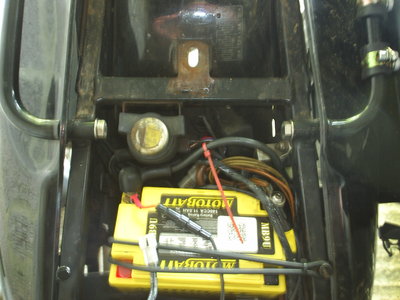

Hi.
Do you still want photos? Out in the garage later so can take them of my 2004 Mastiff.
Cheers

Postby breakwellmz » Sat Feb 05, 2022 8:23 am
Hi.
Hope this helps, not the best of photos i`m afraid -
Cheers.

Clean, really? I`m not one for cleaning and the wiring hasn`t been touched from new because it hasn`t needed it to be honest (new in 2004)
Perhaps you ought to step away from it for a bit before coming to a firm decision, i think you`ll get hardly anything for it as it stands.
Happy to supply further (and better quality!) photos if and when needed.

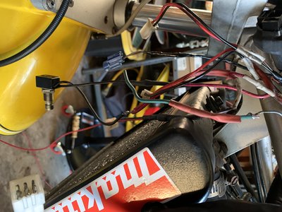

Postby Rizla215 » Sun Jun 26, 2022 10:09 pm
You call that butchered? May I submit:

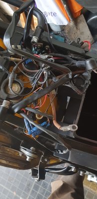

Postby Rizla215 » Sun Jun 26, 2022 10:10 pm
There’s more…
