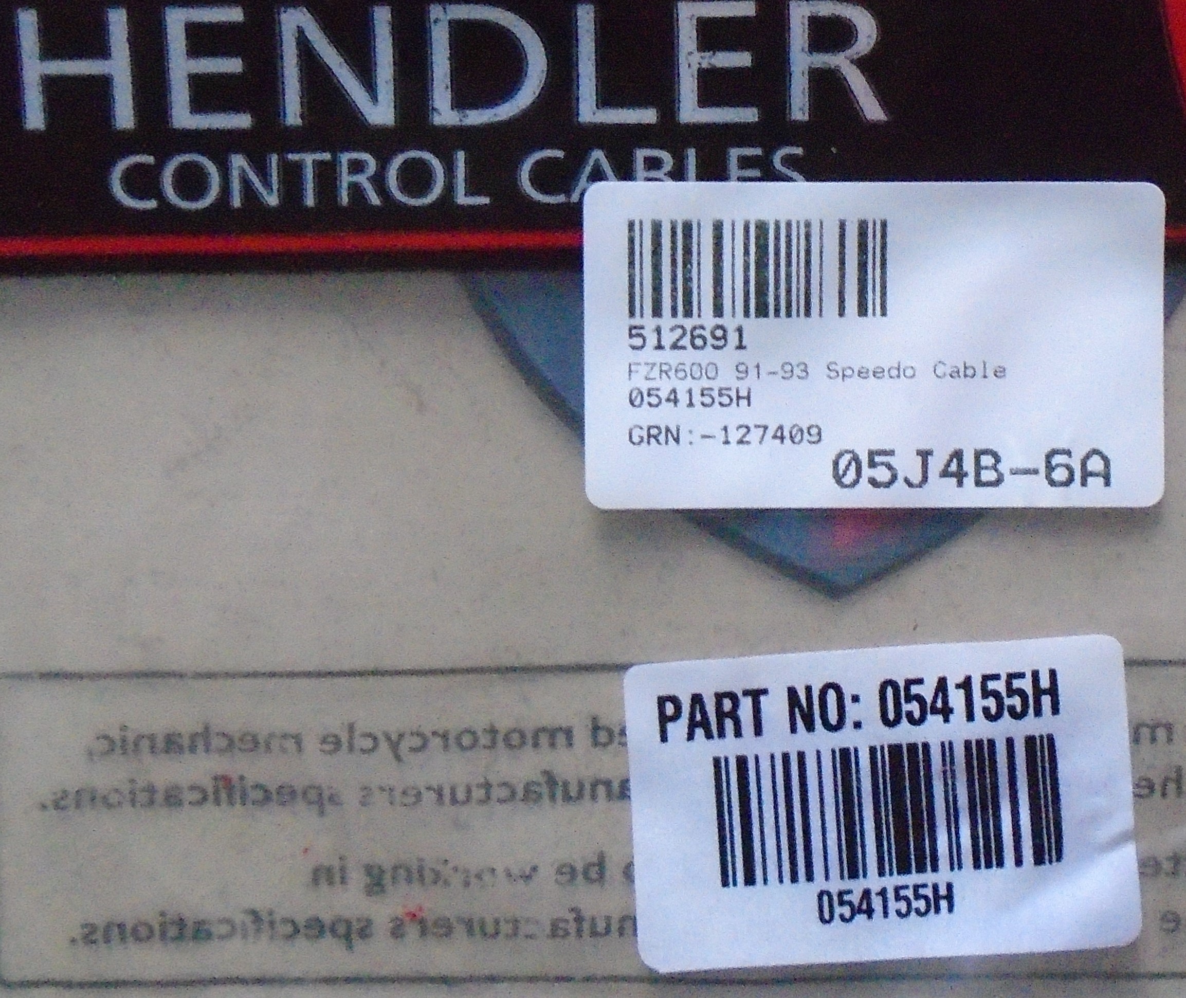

Postby dickl » Tue Nov 15, 2022 10:32 am
I tried sending these details direct to David Thompson, but with no luck, so I posted them here! Attached is a picture of the bag in which the cable was delivered. The label with FZR 600 etc is the merchant's label, and the one with Part No; 053155H is the manufacturer's label. The technical details from the merchant's web site are : length 35.5"/900 mm. 11mm screw over fitting at each end - fits MuZ drive and speedo ends; "square" drive at each end - again fits MuZ Skorpion.
Hope this helps,
Dickl
