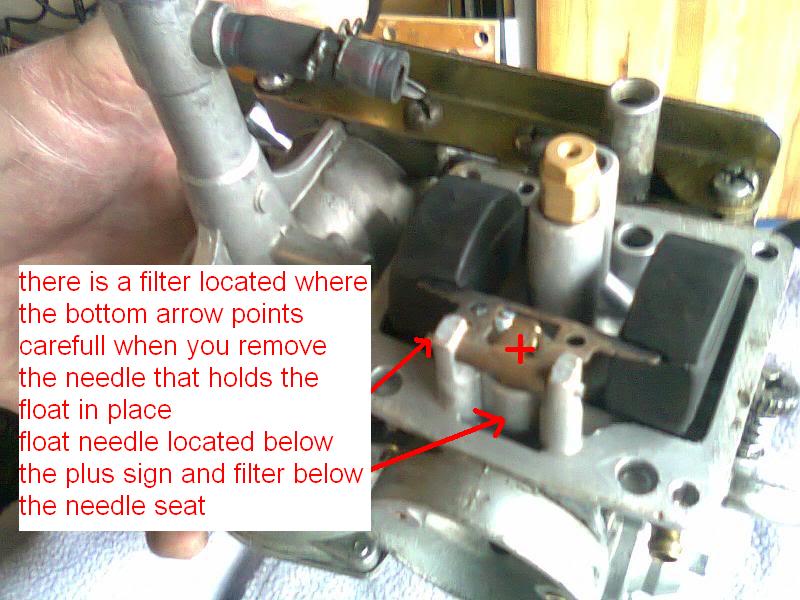

Postby den » Fri Oct 26, 2012 3:35 pm
you doo know about the little gause filter hidden at the back of the float valve,,just a thought,,
den

Postby DAVID THOMPSON » Fri Oct 26, 2012 6:43 pm
links to picture of filter location in above post
the pic
download/file.php?id=2185&mode=view
the group of posts its in
viewtopic.php?f=3&t=4705&p=24870&hilit=carb+filter+hidden#p24870

den wrote:you doo know about the little gause filter hidden at the back of the float valve,,just a thought,,
That guy is clean. Its in a lot of carbs ... its not got fuel flow issues.
