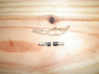

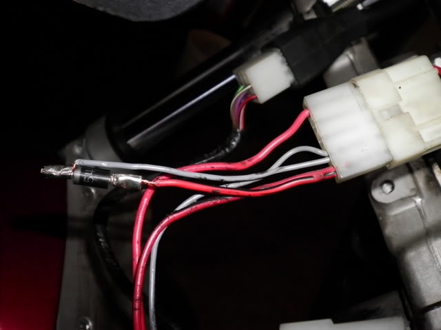

Postby OLDMTNCARVER » Fri Jul 12, 2013 11:25 am
Alun,
Found these two pictures in a file saved as "Diode."
I can't remember who posted these... If I find more it'll be posted.

Re: Need electrical help for baggy
Postby handsomejackuk » Fri Jul 12, 2013 3:59 pm
great, thats very interesting looks like the part of the loom on the front that goes to the ignition switch, looks like i can get the rear and front light to work by tapping off the dash light circuit, I may even put a diode in there too, so its back to original.
Be interesting to find out if that is where the diodes are though...
anyone else care too share some ... views on this..???

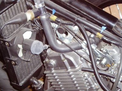

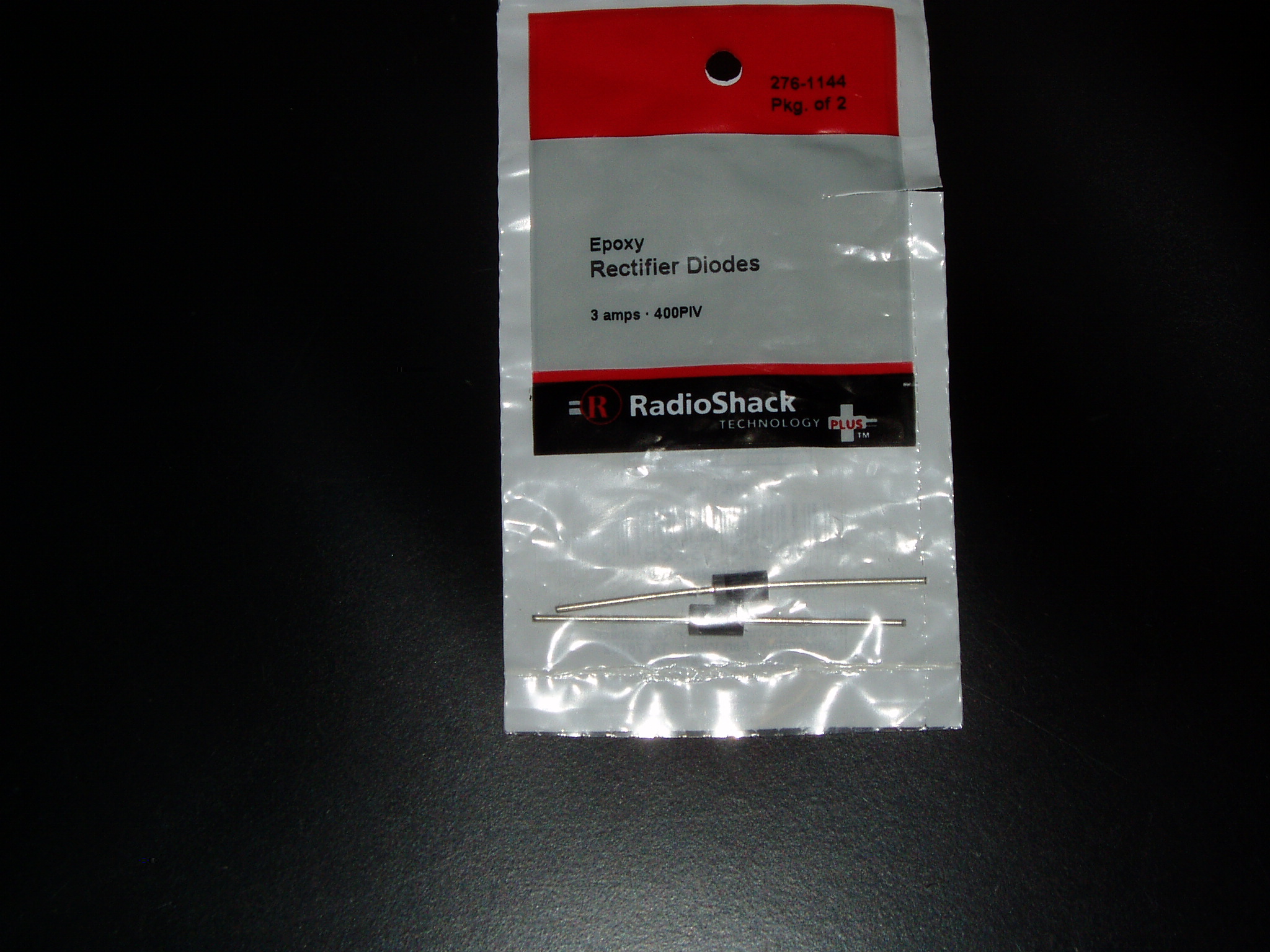

Postby OLDMTNCARVER » Sat Jul 13, 2013 12:23 am
Al,
I believe that the yellow tape on the loom is the location of the other two diodes.
The schematic shows a total of three. With the other one located as you stated by the head set.
This package contains replacements, purchased in the past but have yet to be used. The values are for reference...
Hope this helps,
Robert
Postby handsomejackuk » Sat Jul 13, 2013 5:30 pm
thanks for the pics of the diode locations... thats really uselful info to have. i will investigate the diode in the loom,
I will report...back on my findings..
Al...
Postby handsomejackuk » Sun Jul 14, 2013 2:19 am
OLDMTNCARVER wrote:Alun,
Robert
Robert,
this part of the loom you have photgraphed, is this the original loom, or part that you have modified ?
as my connector only has 3 wires yours shows 5 wires all be it the additional 2 are the diode...
Al...
handsomejackuk
Posts: 938
Postby OLDMTNCARVER » Sun Jul 14, 2013 10:17 am
Al,
After searching the forum I found that those two pictures are from a thread (RE: BAGHIRA 15 AMP FUSE) back in 7-27-2012, the post by billr.
I am to understand that they are from his Traveler which would explain what I also was wondering about...
The second two pictures, one of the engine area and the other of the package containing diodes are of my Baghira.
Robert
